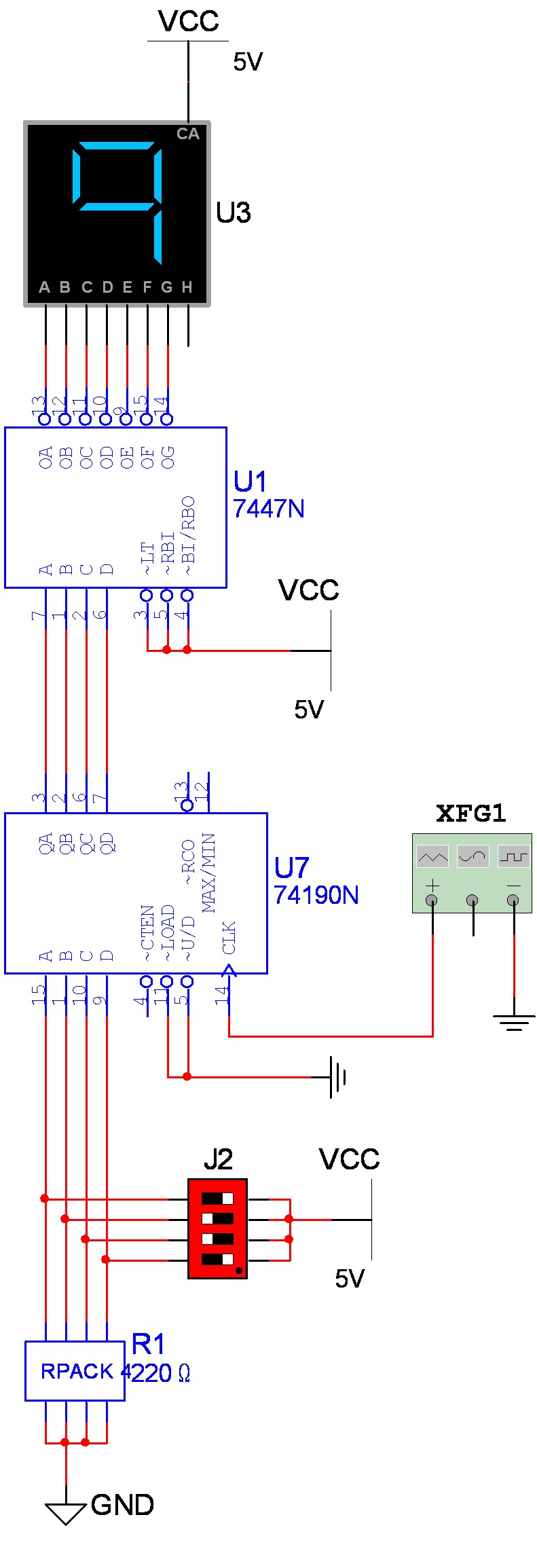

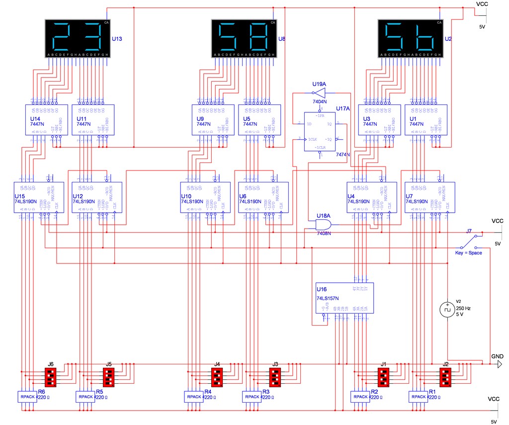

I'm trying to build a countdown clock, I'm at step one which is simply getting one of the circuits to run. I can't get the counter to work at all. I'm using multisim 9 educational, I've attached the diagram of what I have so far. I've pulled the count enable line to high and low with no result.
Any advice is greatly appreciated.

Pin 4 enable needs to be low. The load terminal needs to held high and brought low for an instant.
I think you need to put the 220 ohm resistors to Vcc and let the dip switch pull the appropiate load terminal low.

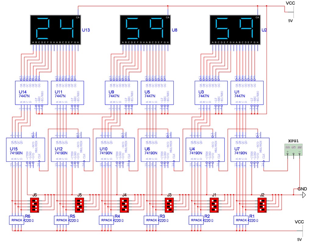

So this circuit now works from:
99:99:99
But I can't get it to work for:
23:59:59
Again any help anyone can offer is greatly appreciated.
I modified it further an can now get it to set a time to count down. I need to figure out a way to have the div counts start back from what they are set. Currently it counts 5,4,3,2,1,0,9,8,7,6,5,4,3,2,1,0,9... (where it starts at five)

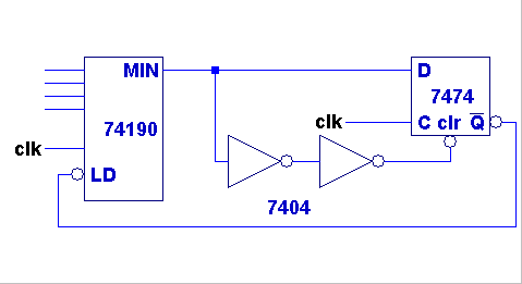

You could use a Quad 2-Input Mux such as the 74LS157 to set the counter values for the divide by 6 counters. The Mux SELECT input is controlled by the J7 Preset/Load switch. This allows selection of either the load switch values or the divide by 6 values for the Counter Preset. (The Mux is not needed for the counters that go to 0 and rollover to 9.)
The Mux Select input goes to J7. The Mux I0 DATA inputs go to the Counter Preset Switches and the Mux I1 data inputs go to the desired count preset value for a divide by 6. The Mux outputs go to the counter DATA inputs. In the J7 load position (Mux Select Low), the counter presets are thus connected to the switches. In the J7 run position (Select High) the presets are set to the hardwired values to cause the proper divide ratio. For example the 10's minute digit would be loaded to binary 5 on the next count after it reaches zero.
Since the counter load control is asynchronous you will need a D flip-flop to delay the counter load signal until the count following 00 for the counters you want to divide by 6. Otherwise it would instantly load 5 when it reached 00. Connect the RCO signal from the counter to the D FF input and the FF Q output to the counter LOAD input. The FF clock should be 2Hz for proper sync of the LOAD signal.
You will also need to add 2-input AND gates at the divide by 6 counter LOAD inputs. The AND inputs are the FF output and J7 so either can control the LOAD function for the divide by 6 counters.
Hope you can follow all that. I could draw if for you but what's the fun in that. As they say in the textbooks, that's left as an exercise for the reader. It's not a trivial addition to the circuit but, I think, doable.

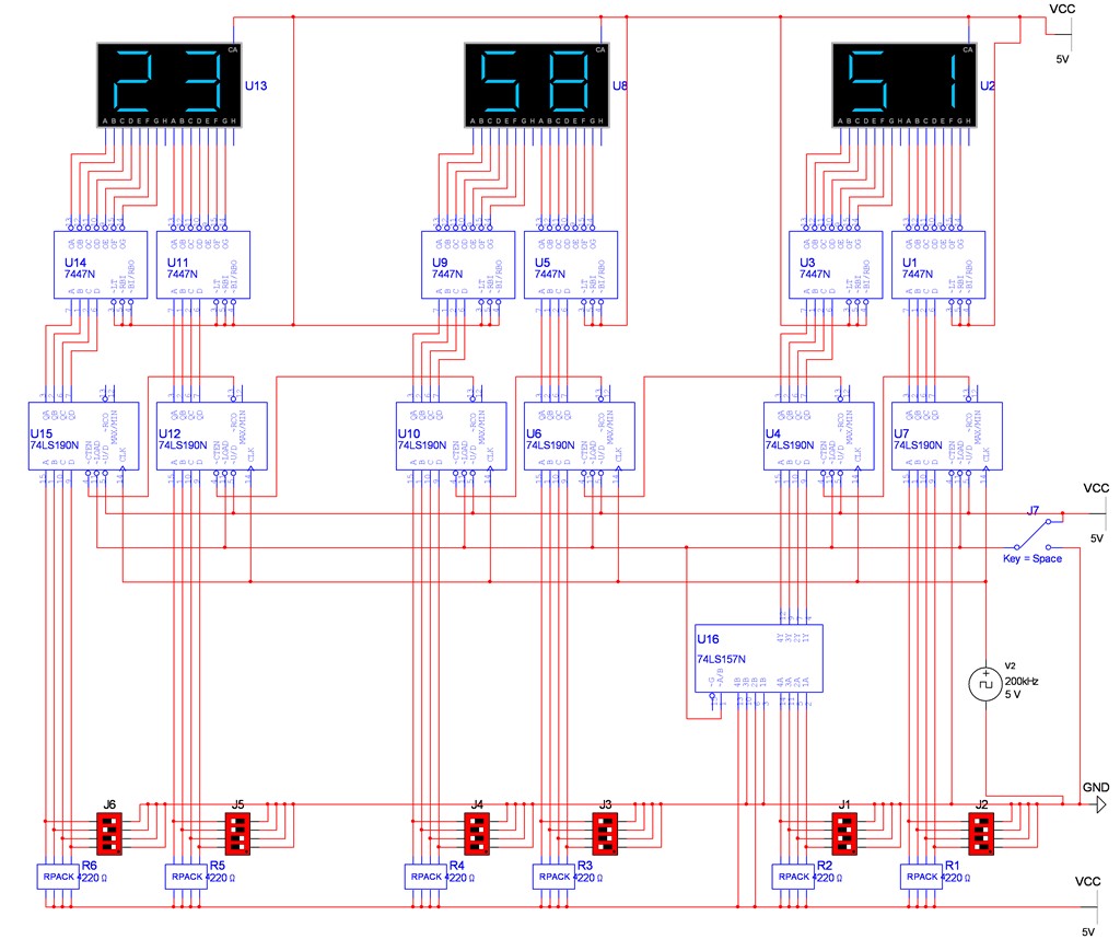

I tried following this, but I get lost when trying to connect all the inputs. I hate to ask but is there any way someone can illustrate this? I've changed the clock to what I believe is synchronous, so now what do I do instead of the D FF?
I thought I had this figured out, but now it counts like this: 15-14-13-12-11-10-9-58-57-56...
I have no idea why.

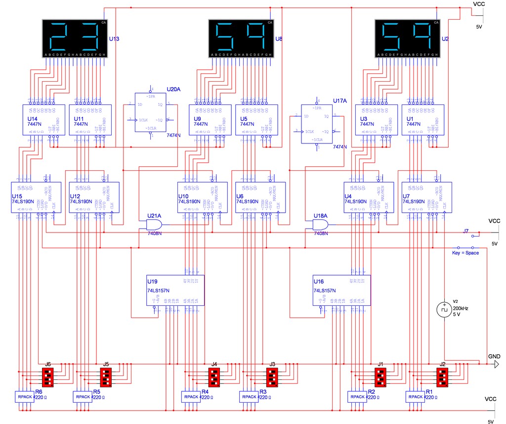

I've attached what I've managed to get done, but again I'm not quite sure what to do with the clock input line. There is one other issue here as well, when you pull J7 high, it overides the time you input into the switches, just wipes it right out and pushes the time to a 5.
The 2 Hz clock should go to the FF CLK, but that's assuming the main clock is 1Hz. You're showing a 200kHz clock. Is that just for test purposes? The FF clock should be twice the input count clock so for a 200kHz input clock, the FF clock should be 400kHz. Also the two clock edges must be simultaneous i.e. the 1Hz clock goes high with the 2Hz clock edge.
I have the clock ramped up for testing.
I thought that doubling the clock may be what you meant, so I tried it with 400kHz and it doesn't work.

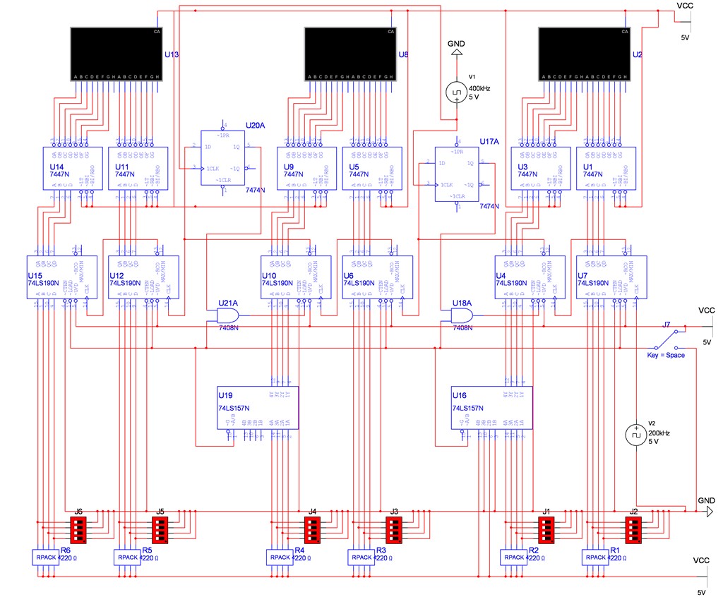

I'll attach a diagram of the circuit, basically it counts 5 for the tens of seconds twice and does some really strange stuff with carrying through to the minutes place. It's kind of hard to explain. I'll attach my mulitisim file for anyone who may want to have a go at this. I'm about to throw my hands in the air, I've spent an awful lot of time on this and it's just for my own purposes. I recently got my hands on a copy of multisim so I thought I'd see what I could remember from college physics, which is apparently very little.

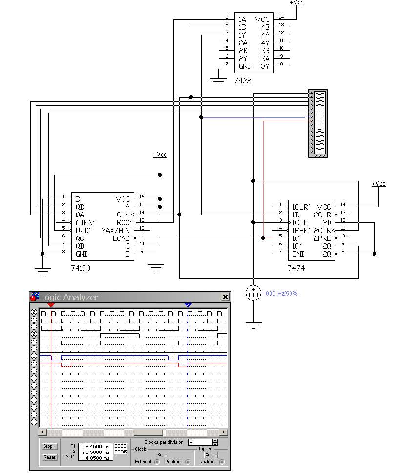

I don't have multisim but I simulated the divide-by-five counter on Electronic Workbench. I found a couple problems on my simulation and I don't know whether they apply to your problems but you might check:
1. The standard clock generator model generated two clocks out of phase, i.e. the rising edge of the 1000Hz clock appeared on the following edge of the 500Hz clock. The two rising edges need to be coincident. I corrected that by generating the 500Hz clock from the 1000Hz using the 7474 FF connected as a divide-by-2 (connect D to Q').
2. My 74LS190 simulation model gave an incorrect RCO output. It should be only the width of the negative clock pulse, but it was equal to a whole clock pulse. I corrected that with an added OR gate. (This should only be needed if the simulation model is incorrect. The actual circuit should operate as stated.)
I corrected these errors and it appears to work properly, counting 5, 3, 2, 1, 0, 5, 4,... Attached is a view of the logic simulation.
TRACES
Top - 1000Hz Clock
2nd - 500Hz Clock
3rd - Counter QA Out
4th - Counter QB Out
5th - Counter QC Out
6th - Counter QD Out (Always 0)
7th - RCO Out
8th - D FF Out
Hope this Helps
So are you saying to use 2 FF, one to cut the time in half and the other to control the div counting?
Yes. I did that because the clocks provided by my simulator were not the phase I needed.
P.S. I noticed in my schematic that the 7474 was not grounded. Pin 7 should go to ground.
So I should use the output of the FF that cuts the clock in half to go into the CLK input of the second FF for div counting right? Could I use the output of the FF that cuts the time in half on all of the DIV counters? Or should I have a different one for each div counter? So I know I have to cut the time in half for the tens of seconds, but do I need to cut it in half again for the tens of minutes?
