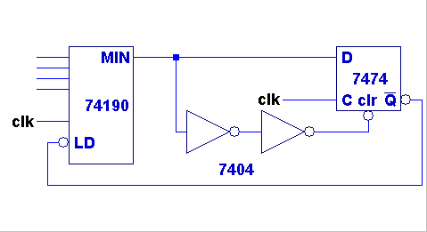

I think you can get what you want by connecting MIN OUT to the D input of a 7474, system clock to the CLK input of the 7474, and the Q* (Q-not) output of the 7474 to the LOAD input of the 74190.
ok now it's working perfectly thanks to that 7474 but still i am getting the 5 twise.. i have the clock set on 1 hz every number takes 1 sec to change exept the 5 it's taking 2 seconds as in i'm getting the 5 twise.. how can i salve that??

Oops! That's to be expected - add a couple of inverters and a connection to the CLR* pin of the 7474, as below. This will shorten the load pulse so that it ends before the next clock pulse.

i followed ur instructions but now it's again not counting the 0 and i still have that 2 seconds delay on the 5
I screwed up. See the revised schematic above in my previous post.

I don't have any way to build this, but I simulated it (including the 74190) and it worked perfectly. Can you post your schematic?
