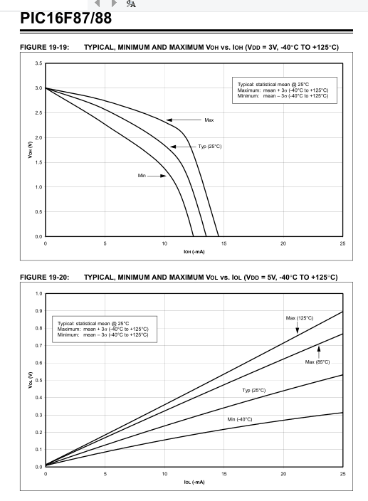

Using Common Anode 7seg LED's, a high side driver (p-ch logic level FET or PNP) can Mux each digit but average current goes down with duty cycle.
As I recall, The ATMEGA CMOS drivers hav an internal resistance of about 25 Ohms and the LED has an ESR determined by size or power rating, often in the 15 Ohm range. This combined ESR will current into a 1.6~2.2V Red LED when driven from a 5V supply and dependent on actual wavelength of Red and Vf @ rated current. If you choose LEDs rated at 2V @ x mA then Ohm's Law estimates current at 3V/40 Ohm or 75mA.
This is ok for LED's for each digit only on for 25% duty cycle but is bad for CPU heat loss and may exceed max power dissipation of chip with 8outputs = 1.125Wmax increase based on above assumptions.
Reducing the voltage to CPU or adding 30 to 50 Ohms in series with each segment Vol driver will lower its power dissipation accordingly and brightness. The **broken link removed** is assumed to have an RdsOn or ESR ~ 1 Ohm otherwise total ESR is increased and current reduced and is assumed to be biased properly such as a logic level FET.
That's why I asked what processor... He's using a pic..
He was planning to limit the LED current by limiting the base current of the driver transistor without realising that every transistor will have a different current because they are not all the same. Then some LEDs will barely light and other LEDs will burn out.
Using a Common Anode Display (CA) with FET drive for the digit and port drive for the segment from 3.3V you can drive the LEDs direct
With a 5V supply the ESR drops to 25 Ohms at 25'C but doubles at 85'C so a small value series R (10~22) for each segment is required for VoL
