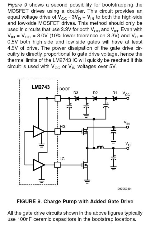

I am trying to build a PWM slot car controller, where duty=100% for ≈4.5s, duty=1%-99% for ≈1s and low-side is only on for ≈0.5s for a 6s lap.
I am using 2 paralleled IRF3711 N-FETs for the high-side. Their Vgs(max) is ±20V, so when the source is at 12V (Vcc), Vgs is 24V-12V = 12V. This is well above the Vgs(th) of 3V but still in the safe zone. FET is fully on.
When the source is at 0V, wouldn't that only be when the high-side is off, so the high-side driver is isolated from the supply? So there would never be a case of 24V-0V = 24V across Vgs? If I'm wrong, could I just place a ≈15V Zener between the gate and the source?
I found this circuit (attached) in a datasheet for a different component. I simulated it and it works, but only for a 1%-99% PWM duty as it doesn't have its own oscillator. But at 100% duty, the gate is only charged once and then only incurs small leakage loses after that. So if Cboot/Ciss => 0.1µF/2980ρF ≈ 33 bigger, the small leakage loses would take a while to drain the bootstrap cap?
Thanks,
Ken
IRF3711 N-FET
L6387E Half Bridge
PS. Ignore the text in the attached document regarding max Vcc voltage.etc.
OK I simulated the charge pump from IRF DT92-4 and it worked correctly. I breadboarded it using all the same connections but charging its own final Cboot, and all was good. I connected it up as per the diagram and pop, bye-bye half-bridge. Not to fear, they come in a pack of 5! Maybe just a wrong connection, but I decided to give my 555 charge pump a go. I modified it to look a bit like DT92-4, referencing it to the source of the high-side FET like dknguyen suggested (see attachment). Perfect! I can now 100% duty a high-side FET all day.
