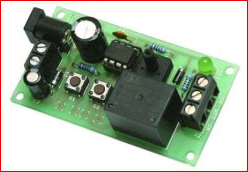

I have built and installed a delay circuit using two 555 timer pcb's into my car so that a brief press on either of it's operating switches will make the indicators work for a pre determined time. I came across this feature on a hire car once and quite liked the convenience when overtaking.....just hit the stalk (or the buttons in my case) and the indicators will flash on their own 3 times (or whatever you set it to).
It works absolutely fine utilising two very conveniently located OEM push switches.... one on the end of the wiper stalk for the right and one on the indicator stalk itself for the left. It was not possible to use the stalk itself to trigger the 555's as it upset the two data lines coming from the BSI unit. Normal functioning of the indicators remain unimpaired.
The way these 555 pcb's operates is as follows.
They are powered up permanently. When one or other of the momentary push switches is closed and released, it starts the timing sequence in the 555. The on board SPDT relay changes over and places 0v (vehicle earth) on one or other of the data lines from the BSI. This causes the indicators to blink. After a pre-determined time, 555 chip times out and releases the relay, thus removing 0v from the data line and the indicators stop blinking.
The problem I get is that when I turn on my headlights (55W HID) the ignitor circuit for those arc bulbs seems to be putting a huge spike across the 12v system and both the 555 timer pcb's self trigger.
I think I need some sort of suppression somewhere on the supply line but don't know what/where to put it.
Any ideas?
The two 555 pcb's piggy backed together.
The circuit.
What do you need....a circuit diagram of the 555 pcb's?
These were off the shelf kits from Maplin (in the UK). They didn't come with a circuit diagram as such.

That might do it, alec. Don't see a cap on 2 (see below - pic from another angle off the maplin site (the one ceramic is, presumably, attached to pin 5):

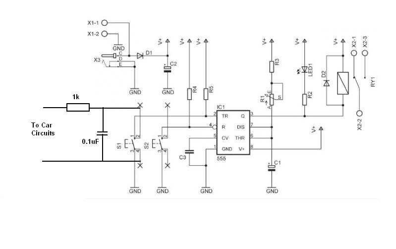

I found a schematic of the 555 circuit that I'm using here if it's any help.
My trigger wires out to the momentary push switch are taken from the two points marked as 'X' from S1 on each board.
You're right, there's no cap on pin 2, just a 10k pull up resistor......so I'll try adding one on each board. Easy fixes first though, I'll try the twisted pair route to see if it improves things.:)

OK, I am coming late to the discussion and without actually seeing the equipment, the best suggestion that I can make is to put a simple low pass filter on the inputs as I have indicated in my attached edit to your schematic.
You are already part way there with the 100nF cap, but adding the 1k ohm resistor MAY make all the difference.
Give it a try and see what happens.
Thanks for the reply Jim and taking the trouble of adding to the diagram.
As a sparky, I understand what components are meant to do, but can you explain how this R/C filter works. Is it something like getting the unwanted spike to charge up the capacitor instead of finding it's way into the trigger line on pin 2?
I guess if unsuccessful, maybe I could play around with component values a bit?
