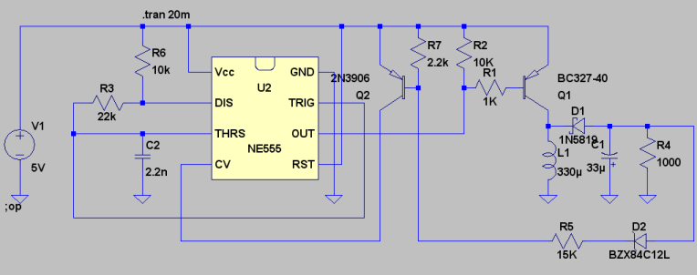

Since I have a number of large LCD's which require negative voltage for the glass (-8 to -25V @ 8mA max) rather than buying up some max637's or something, I decided to set myself the challenge of coming up with a relatively 'simple' inverting buck boost converter. Input should be 5v output sohuld be fairily well regulated at -12v (we'll work on -25v later) as only a few mA.
Now, switched capacitor converters are great but they don't really do 5 to -12 conversion, mainly just invert polarity of the input voltage.
So far, I have come up with this. Not as simple as I would have liked but it 'seems' to work in LTspice switched CAD at least.
two PNP transistors, inductor, shottky diode, 555 and a few passives. Efficiency is nothing special, although, with a 1kohm load (12mA max out) seems to be roughly 72% - not bad.
Any hints, pointers, criticisms are more than welcome, since its been bugging me for hours.
Cheers!
Blueteeth

It looks like it will work, it's nothing special but it's probably the simplist way of doing it.
Are you using a micro controller anyway?
Why not ditch the 555?

Hi Blueteeth,
as hero already said the circuit will work.
However it will deliver about 1mA without voltage loss.
A better way is supplying the NE555 inverted (-VCC to ground pin and VSS to V+ and /RESET. You just need to rectify the negative voltage and add a smoothing capacitor, this way getting an output current of ~250mA without voltage loss.
The output of the timer swings from -0.02V to full -VCC.
Alternatively you might use a DC/DC inverter SIM1-SIL4 (isolated input/output)with a footprint smaller than a DIP8-package. Datasheet attached.

Hi guys,
thanks for your replies!!
I noticed that you recommended using voltage doublers (caps + diodes) along with an oscillator. That was my first thought but the reasons I chose to avoid it was:
- With an input of +5V, -5V would require one stage, -10V two, -15V three (not including diode losses). As the capacitors would be 1uf+ it becomes quite a large circuit - restricting us to -5 to -10V max.
- For this app, its low current, <15mA. Sure a well designed voltage doubler chain could provide more current, but I don't need it. Whether it be for LCD biasing, or opamp power supples - nothing is going to draw more than a few mA.
I wanted a circuit which could be used to provide -VCC all the way to 4* -VCC, by only changing one or two comonents. The 555 is a pretty cool chip for basic SMPS, since it has a SR latch, and two comparators with access to their references. There are of course alternative 'basic' circuits. Using TTL logic for the oscillator for example - I've used a 74HC05 for a simple 5 - 13V converter for a small PIC programmer, that required 6 parts.
I'll post a schem of the transistor version when its done. Uses 3 PNP transistors, so it fairly small.
Blueteeth
I think the SMPs with the inductor, is the best idea.
The voltage increase is too much for a charge pump, not at any reasonable current anyway.

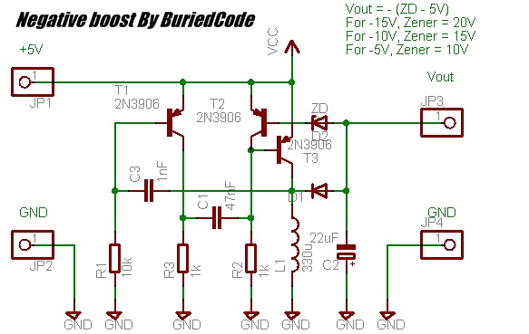

Here's the 3 transistor version. Again efficiency isn't great, but doesn't draw more than 100mA for a small -15V @ 10mA output. - more than enough. Feel free to mod/tweak to help me improve it. - with standard parts.

I simulated the circuit and at 5V supply voltage the maximum output voltage is -7.7V at 8mA.
I generally simulate circuits on a proto board, computers lie every chance the get. Obviously, there are diode drops and the cap values could be tweaked based on load current, but the circuit is a voltage tripler so it will get in the ballpark of -10V. The easiest way to get a bit more voltage is to increase the 5V source a little bit.
As long as your circuitry can stand the EMI from having a small radio station inside the enclosure.
GOod point, its bitten me in the arse before (boost converter for a wireless sensor). But with sheilded inductors, and no sensitive analogue, works fine :) Also the currents in the above circuit are pretty small, peak is about 200mA in the inductor I think.
Ferrite beads and ceramic capacitors on the output also help a lot.
