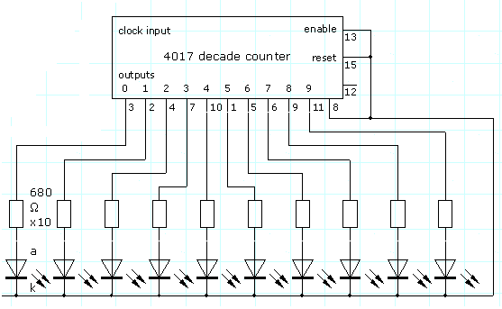

Hi, when ever i connect power to the 4017 the outputs are random and dont start at output 0 (Pin 3)
i was just wondering if there is a way to get it to start at pin 3 when ever i connect power, i am using a 555 1 second square wave for the clock, with a cap on pin 8, so it has nothing to do with spikes on the 555.
So does anyone have any ideas on how i can fix this problem

you will have a random counter if you don't reset the chip. Take pin15 high to reset and low to count. After a reset count starts at zero.
Your schematic doesn't have a power on reset either.
matk95 definetly, when its running all the LED'S light up in order, its just that it starts random when connecting power?

Yes, But i just tried connecting pin 15 (Reset) to +V and it also works 100%, but the tutorials say for normal operation connect pin 15 to ground, well that gives a random start, to me thats not normal operation?

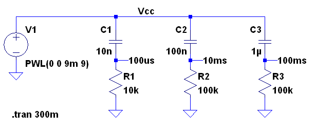

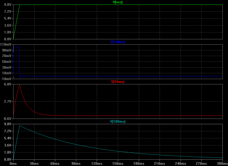

Make the time constant longer. If your power supply has a slow risetime when you turn it on, you won't get a good logic high at the reset pin with 10k and 10nF (that's only a 100usec time constant). Try 100k and 100nF, or even 1uF.
Here's a sim that shows what I'm talking about. I set the 9V power supply to rise at 1 volt per millisecond, just as an example. You may be using a different voltage, and your turn on slew rate may be different, but the principle still holds. I show the reset voltage for 3 different time constants.

If you are using a switch between the power supply and the circuit, or if you have a battery, then it will work fine. If you are turning on AC power to a power supply, it could require a longer time constant.
