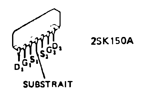

2sk150 ??
tab a
This is in the Toshiba receiver I'm working on but I can't find a data sheet for it anywhere.
I'd like to know what it's supposed to do. :) Anyone have info on it?
Thanks.
Hi Tab a,
Does it look like this ?
on1aag.

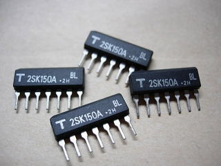

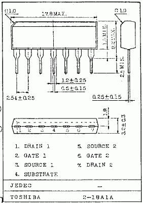

Is this what you seek?
  • 2sk150.pdf
I don't know that I need one--yet, just would like to know what they do, and pin outs, if possible.
Thanks.
Hi Tab a,
It's a dual fet, usually the differential input stage of an (audio)
power amplifier. Like in a Nikko Alpha 440, Nikko Alpha 220, . . .

Here is the Pinout from the Datasheet.
2sk150-pinout-gif.13323
