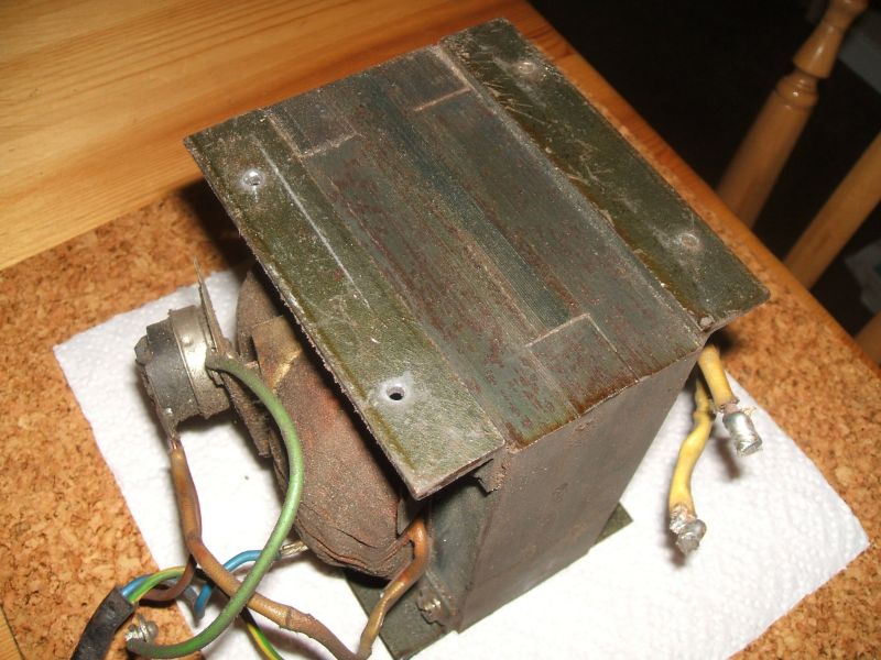

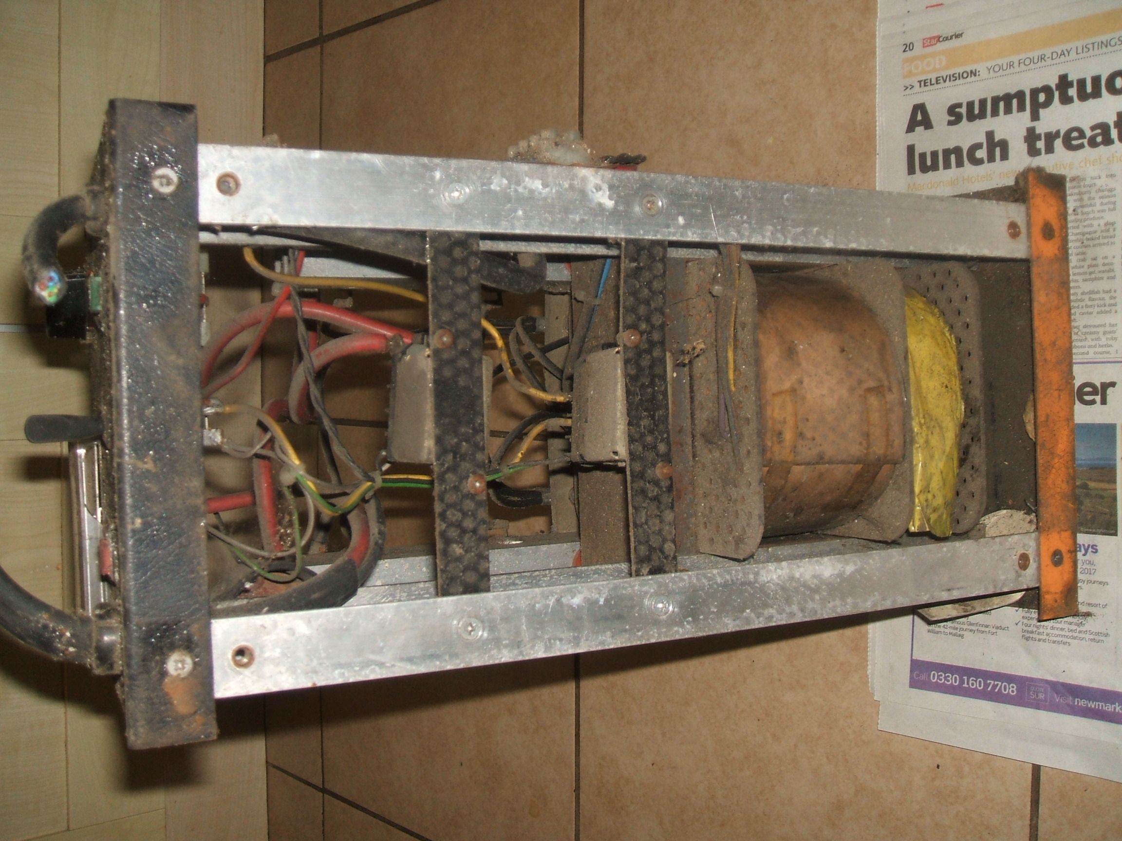

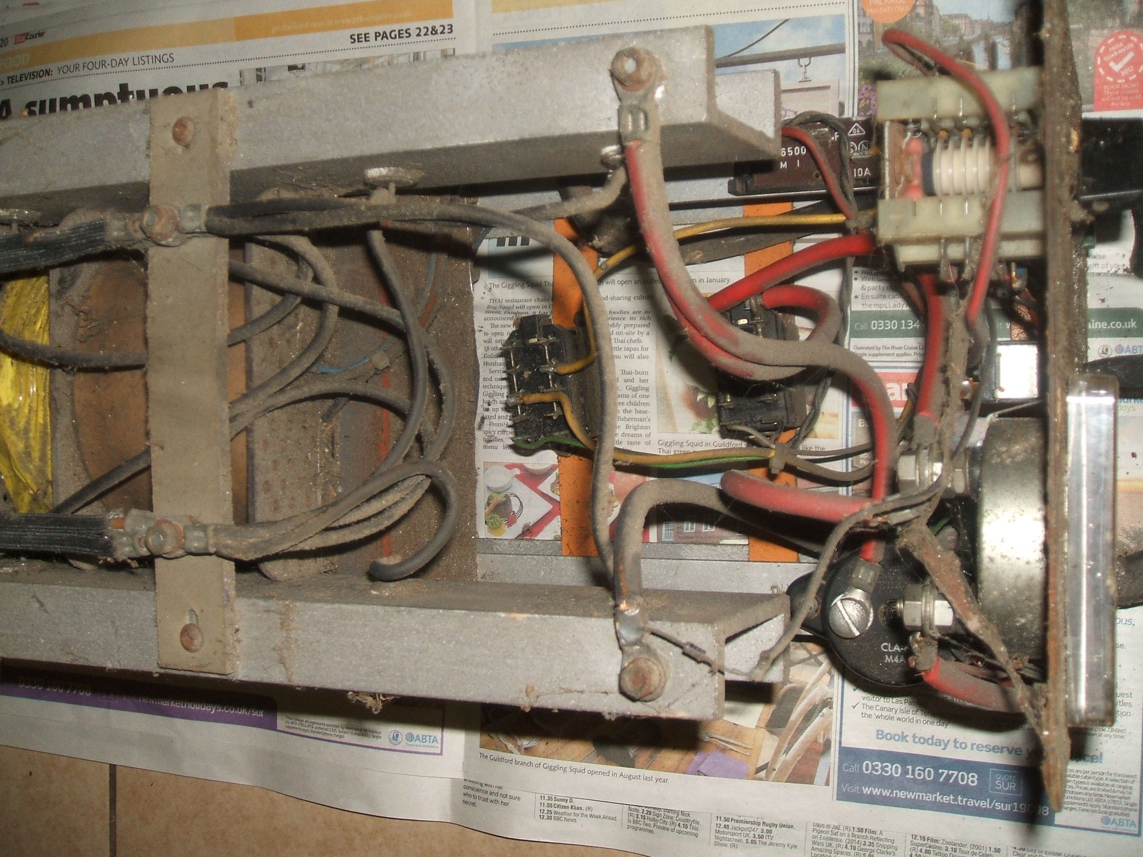

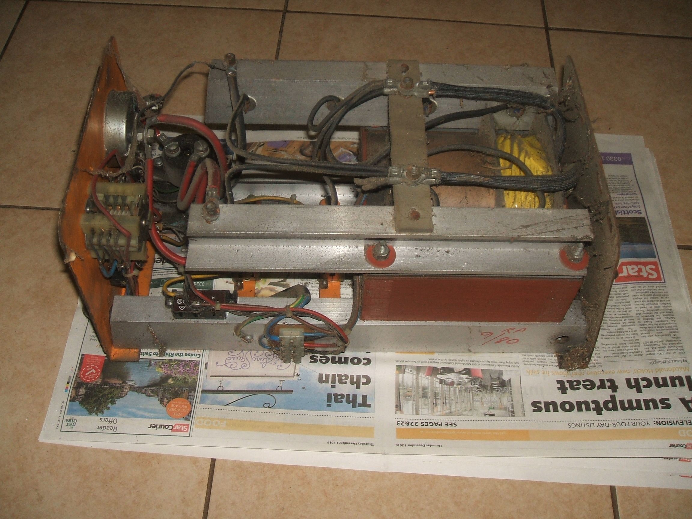

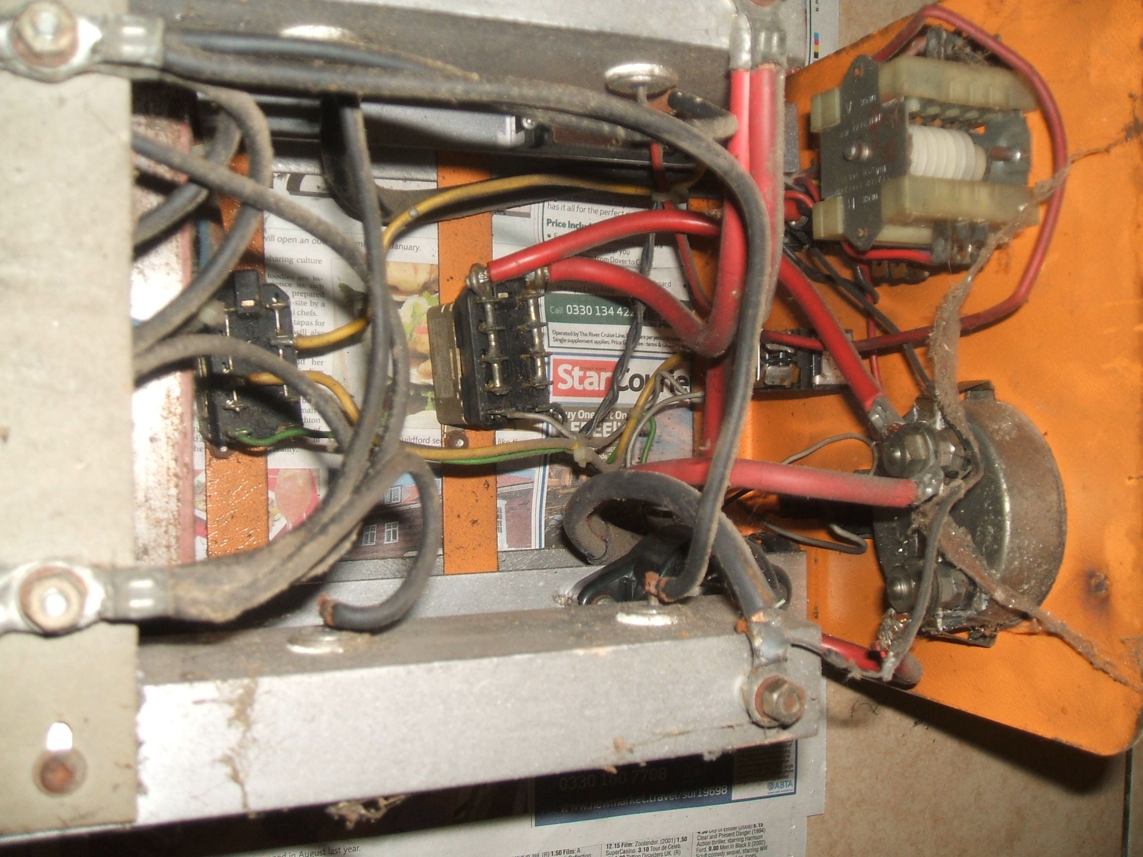

Have a good look at the photographs that follow. It's an XP Metalworker transformer of 40V and 80A (total overload)
The main ones are of a car battery charger / starter circa 1969. There's no insulation on those diodes on the frame. 4 each side. The frame is insulated.
