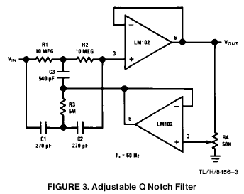

Here is a circuit of a 'notch filter'
They can be very effective, but i think they are intended for
sine waves.
If the 22 Kilocycle you want to filter out is not a sine,
i suspect it would not be so effective.
In which case you need to look at other ways of minimising it.
Regards, John :)

22KHz is the same frequency no matter where it comes from, sine waves, square waves or music. A notch filter will eliminate it but not its harmonics.
Your simple "twin-T" notch filter will seriously reduce frequencies within a few octaves from its tuned frequency. Adding positive feedback to its "ground" point from an opamp buffer at its output will sharpen the notch so that it is extremely narrow. An opamp that is good at very high frequencies must be used to obtain a deep notch.
https://www.electro-tech-online.com/custompdfs/2005/09/LB-5.pdf

Hello guys,
First of all I would like to say thanks for all of your replies to this thread.
The filter will be used to solve a problem that is caused by a switching device that will switch between multiple LNBF's on a satellite dish. The switch works on a 22KHz tone (the receiver sends down the line to the switch) that will switch the dish's LNBF to another satellite when this tone is present.
The problem is that the 22KHz tone will bleed through to other LNBF's and cause them to switch when they are not supposed to. A simple blocking of this frequency will stop that, if installed between the switch and the LNBF.
I am not an electronics pro by any means, maybe it can be exlained better here:
This actual quote is taken from another forum discussing this same problem:
"Should be easy to create an effective 22 kHz rejection filter with a properly sized inductor and a cap in parallel.
That way the high freq. IF passes through the cap with ease and the DC passes by way of the inductor, while blocking 22 kHz.
I'm guessing a cap in the range of .001uF along side of a healthy sized mH RF choke would do the trick."
If someone can give me ideas, or a formula to calculate the inductor/capacitor values needed, I would certainly give it a try.

Hi JohnSmith,
Yes an L-C will give better results than an un-assisted R-C filter.
In addition to the filter you could reduce the strength of the 22kc
signal, stray pick-up is usually very much smaller than the signal
proper. Reducing the signal may be all you need to do.
The optimum values for such a filter are those which would resonate.
So the calculation is straightforward, however you cannot rely on
calculation alone to tune a resonant circuit, allow for adjustment.
Probably by adjusting the inductor core. Variable capacitors would
not be of sufficient value to make any sensible adjustment.

You don't appear to have understood his question (now that he's told us what it is!), an opamp filter would be completely useless for doing what he wants.
Bear in mind it's to go in a section of coaxial cable, with no other power connections to it!. It has to perform the following requirements:
1) Pass 13V or 17V DC (switched values to select horizontal or vertical polarity), current about 250mA, from the receiver to the LNB.
2) Pass the RF signal back from the LNB to the receiver, this is about 700MHz to 2150Mhz (high UHF, low microwave), and is the first IF of the satellite receiver system.
3) To provide a further switch in the LNB (high/low band switching), a 22KHz tone can be superimposed on the 13/17V supply, it's THIS he's wanting to suppress!.
The specification of the 22KHz is:
Amplitude 0.6V +/-0.2V, frequency 22KHz +/-4KHz.
I would suggest two possibilities?.
1) A series notch filter across the cable (inner to screen) to short the 2KHz to ground.
2) A parallel notch filter in series with the inner core of the cable, to reject the 22KHz travelling up the cable.
The calculations are the same in either case, just the wiring is different.
frequency = 1/(2 x Pi x Squareroot(L x C))
With Frequency in Hz, L in Henries, and C in Farads.
However, I suspect problems may occur with layout, bearing in mind it has to work at 2GHz?.
