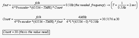

i am doing a simple project of generating 1 second time delay and i choose timer1 of pic micro controller (PIC16f877a)
the formula i have chosen to compute the time delay is like
so for 1 sec the count value comes out to be 15
register bit selection is as follows
  1. TMR1ON=1; // the timer is enable
  2. TMR1CS=0; // internal clock source
  3. T1CKPS0=0; // Prescaler value set to “00”
  4. T1CKPS1=0; // which means 1:1 (no division)
and according to the calculation above my code is for 1 sec as follows( iam using mikroc compiler and proteus for simulation) :

i think iam doing right but the code does not work
anyone please tell me what wrong with it

You can't, which is probably why the code doesn't work as he expects
TMR1IF is defined as 0
so this
while(TMR1IF==0); // monitor the timer1 flag for overflow
is always true
What he needs is
while(TMR1IF_bit ==0); // monitor the timer1 flag for overflow
which accesses bit 0 of PIR1
or this does the same thing.
while (PIR1.TMR1IF == 0) ;
