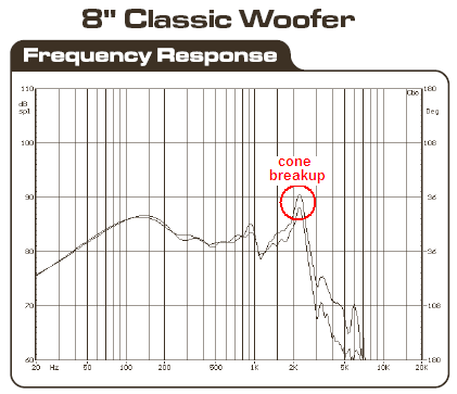

My "two cents" is that most woofers have cone breakup at about 5khz and sound awful producing a shrieking resonance. They need to have a lowpass filter.
What does cone breakup mean?
Will 5kHz kill the woofer?
Cone breakup means that the entire cone is no longer a piston and the frequency response has a peak at the frequency.
Here is the frequency response of a cheap 8" woofer at The Parts Express. it has pretty bad cone breakup at about 2.2khz so it probably cannot be used in a two-way because if the peak is rolled-off then no tweeter can go down as low as about 1khz to mate with it.
Is that because the outside of the cone can't keep up with the inside?
