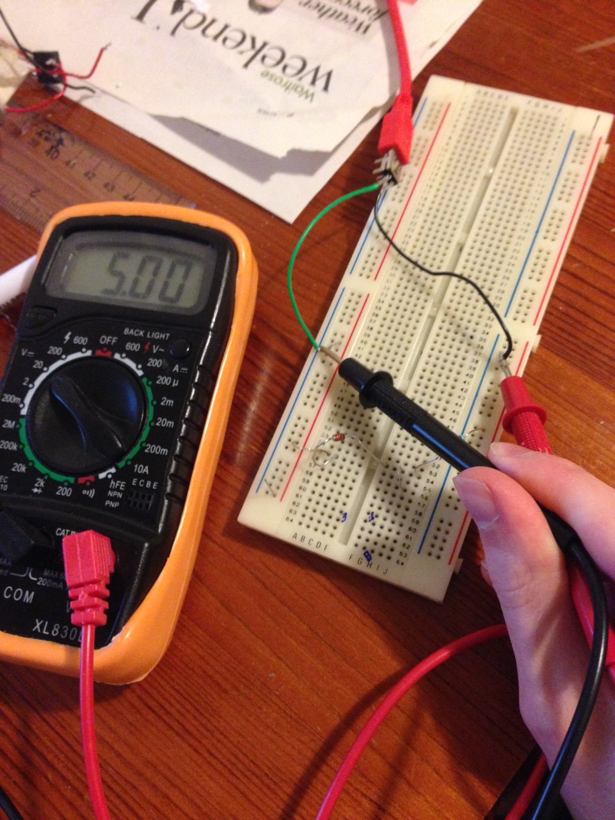

I have been experimenting with a zener diode circuit all day and I still can't make much sense of it. Mathematically it does not add up if If I am doing my maths right based on zener diode voltage regulator google results. The circuit is from a USB supply, dropping the voltage down to 3.6V (3.7V which is fine) and allowing 200ma to go through the circuit to wear some batteries will be connected for reverse charging at 1/10th of there capacity.

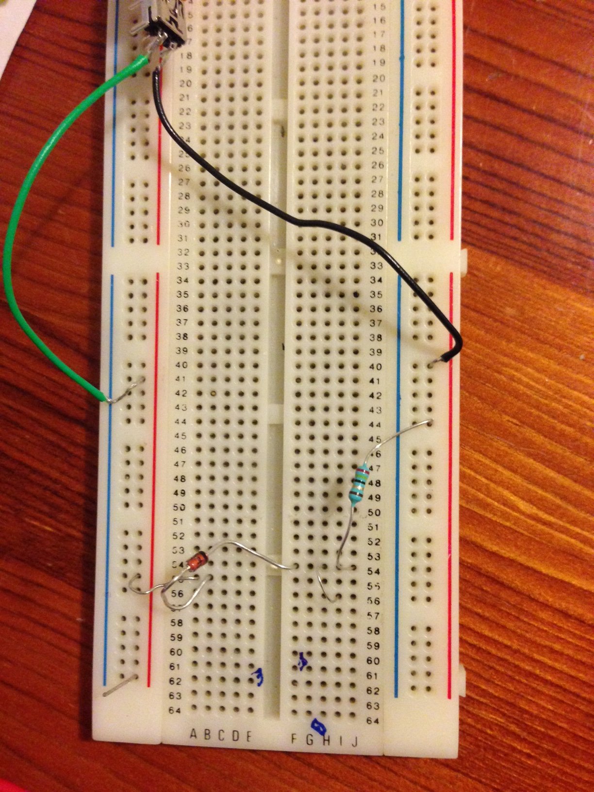

I have used the followingg configuration for the pictures. The zener diode is 3.6V rated at 1.3W. The resistor I have used is 25ohms.
+'ve (5V) --------------------[25ohm resistor]------------------------------------->
[zener diode: 3.7V @ 50ma] (Voltmeter reads 3.69V at 190ma from these points)
-'ve ----------------------------------------------------------------------------------->
I don't understand why a 25ohm resistor seems to be giving me what I want. According to zener calculators and my own calculations it should be a 5ohm resistor, but when I use this the resistor just gets really really hot and the zener does not operate properly. Here are some pictures, btw the black wire from the USB is the positive pin:

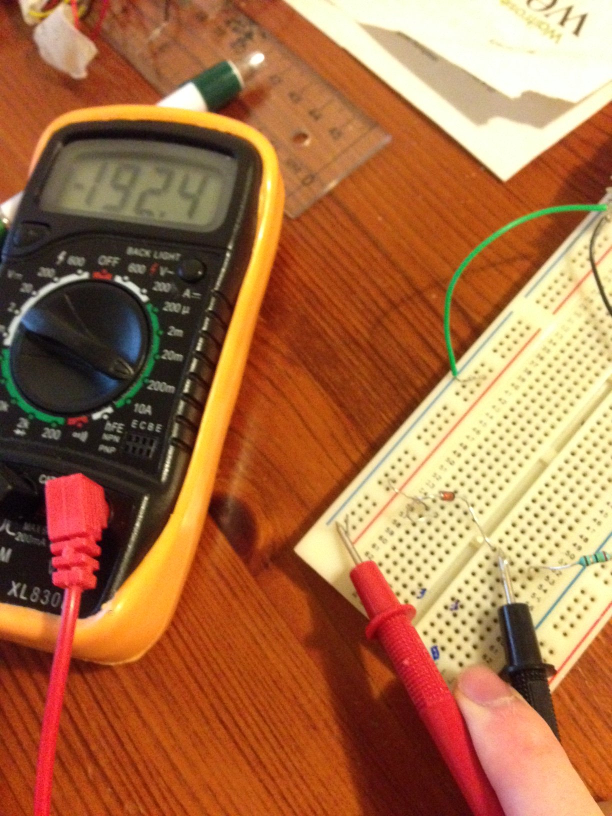

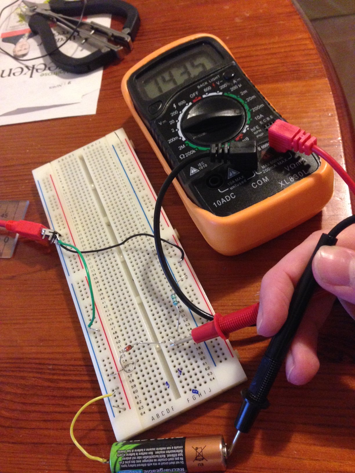

CURRENT ACORSS WHERE BATTERY WOULD BE CONNECTED

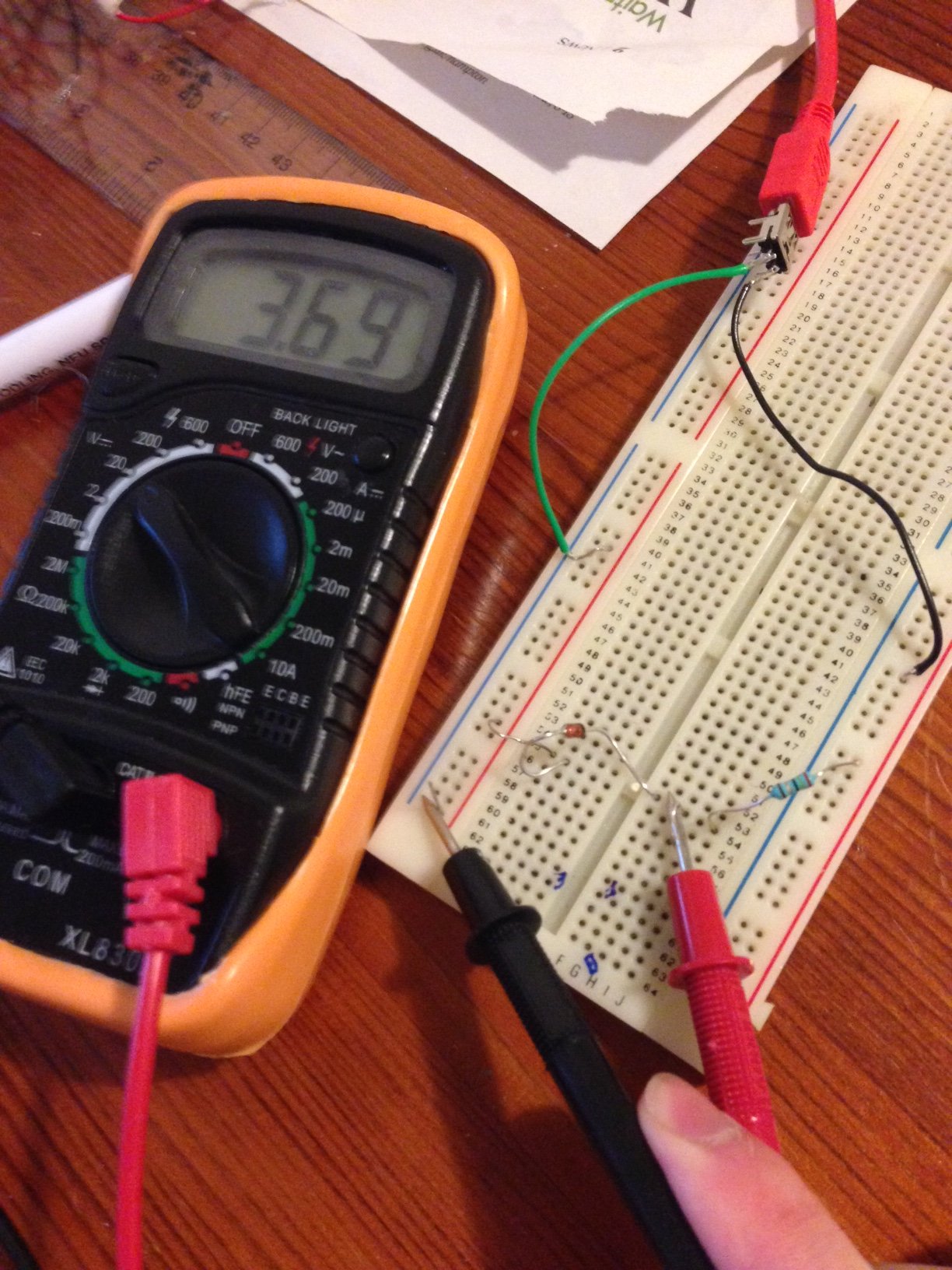

VOLTAGE WHERE BATTERY WOULD CONNECT (ZENER VOLTAGE)
THE CIRCUIT

Too much current through the zener will kill it. Also a zener will have higher voltage drop when conducting higher current.
In your first photo you are bypassing the zener diode since you have the meter connected between the resistor and ground
You measure voltage across devices, current through them.
Disconnect the ground end of the zener diode and then connect the meter between ground and zener diode so you are measuring the current 'through the zener diode and resistor.
Thanks for the reply. Measuring that in that way, the zener is drawing 50ma. However, what I am trying to determine is the current I can gain from the two points which I measured in the pictures which can then by connected to a battery. **broken link removed**

In your first photo, the meter is set for measuring mA and it is shorting the zener diode. If the voltage source is 5.0V and if the meter is 1 ohm then the current is 5V/(25 ohms + 1 ohm)= 192.3mA. Yours shows 192.4mA. The resistor is being fried with 192.4mA squared x 25 ohms= 0.925W but it is too small to dissipate such a high amount of heat. Its maximum allowed heating is probably only 0.25W.
Why are you overcharging the battery cell with a voltage way too high for it? The voltage should be limited to about 1.4V to 1.5V (not 3.69V) and the current should be limited to about 245mA. The charging must be monitored by a circuit that detects a full charge then disconnects the charger.
Basically, your zener diode does nothing when the battery cell is charging and is overcharging. The battery voltage might rise to 1.4V then its charging or overcharging current will be (5V - 1.4V)/25 ohms= 144mA. You measured 143.5mA. A Ni-MH cell must never be overcharged, a fully charged cell must have the charger disconnected.
Basically, your zener diode does nothing when the battery cell is charging and is overcharging. The battery voltage might rise to 1.4V then its current will be (5V - 1.4V)/25 ohms= 144mA. You measured 143.5mA. A Ni-MH cell must never be overcharged, a fully charged cell must have the charger disconnected.

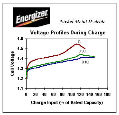

A Ni-MH battery cell charges to 1.4V. Each cell is about 1.2V when it is about half charged.Then three need 4.2V. The 3.6V zener diode will prevent a full charge.
Energizer and a Japanese battery manufacturer say that the trickle charge current for a Ni-MH cell should be its mAh rating divided by 40 or more so for your 2450mAh cell it is 61.3mA or less. The 25 ohm resistor will have about 6V - 4.2V)/25 ohms= 72mA which is too high. Use older Ni-Cad cells if you want a trickle charge at 10% of its mAh current but a Ni-Cad cell has less capacity so the trickle charge current will be the same.

Wow I did not know this ^^^ thanks for the information. Never got taught that at University, I think they just kept it simple and used the nominal voltage of 1.2V by the looks of it.
If this is the case then I might as well start looking at smart charger IC's now. For now, I might as well use one normal diode which will cut the voltage to 4.3V and stop any reverse leakage going back down the USB. This will mean the device itself will also self power off 4.3V but this should not effect anything in combination with the capped 500ma current from the USB. The main IC on the board can handle anything up to 5V so this should be fine. Going to start looking at charging IC's, I think I need to now with this extra information.
