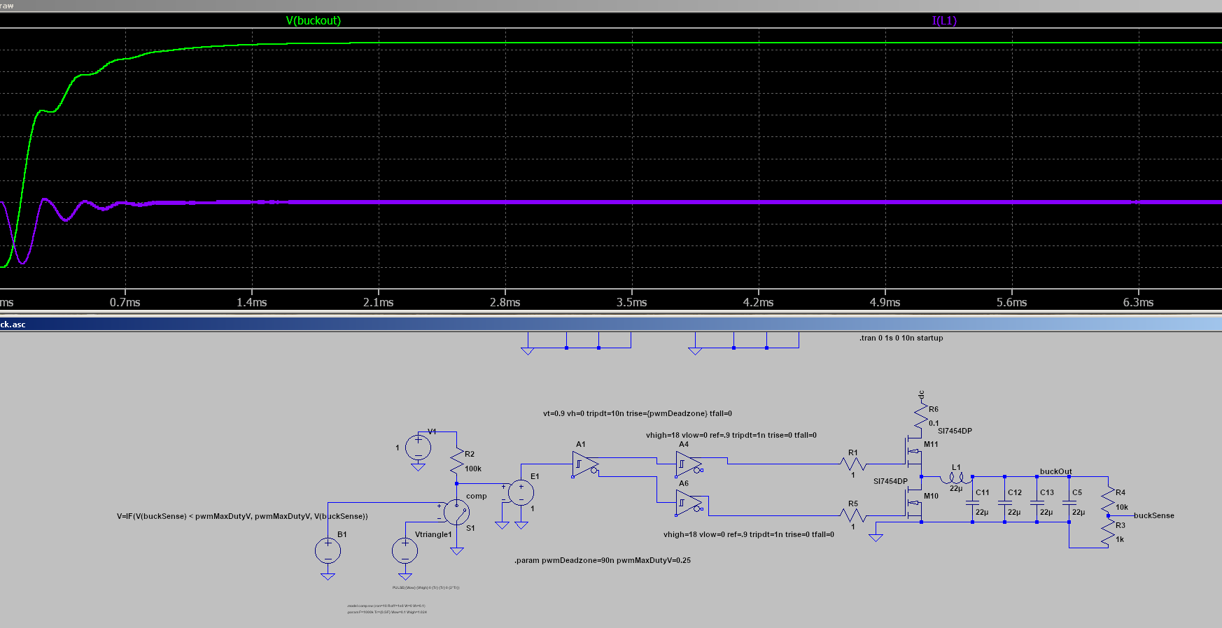

I'm having to make a SEPIC working between 6-100V and I've focused on the buck for today.
I have it working and it's crawling along "nicely" thanks to the 1MHz speed.
When the next prototype goes to fab this section will be controlled by a pic's PWM, ADC and deadband peripheral. I've mimiced these in the circuit.
As you can see the feedback is set for 5.1V.
Two comparators will stick 18V into the gates (so yes, I'll not actually be working with any real current over ~12V but it won't fry either).
First question, R1 and R5 are to prevent ringing but at anything greater (i.e 10 oh)m the pwm is badly distorted. Should I just remove them and rely on the comparators push/pull current limitation?

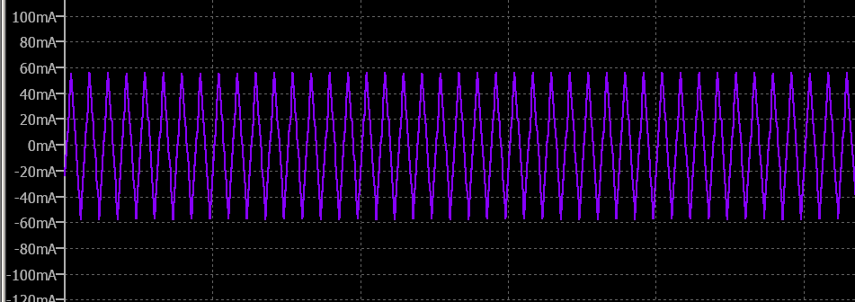

Second question, you can see that there's some current movement through L1 which reduces with a larger inductor. At 1MHz I expected to use something around the 10uH mark. Any recommendations here? I'm happy with 60mA @ 5V but wonder if it can be bettered.

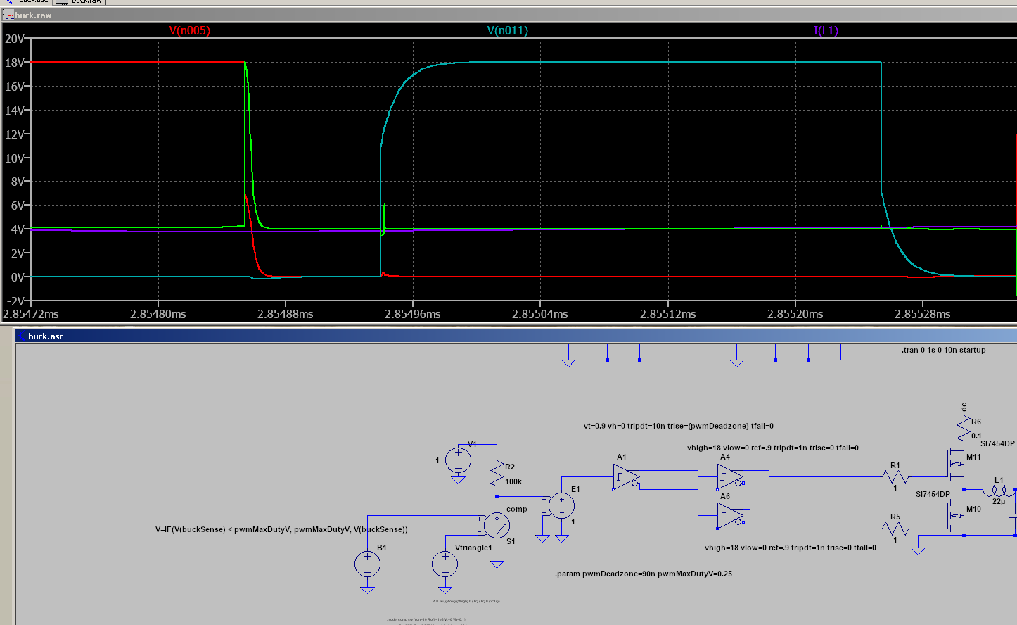

Third question, I stuck R6 in to see if the deadband it working correctly, which it is, but when the M11 (high side) fet switches there's a short burst of current through R6. It's cut off the picture here but it is 3.5A. Any idea what causes it and should I be concerned?
Simulation attached.
