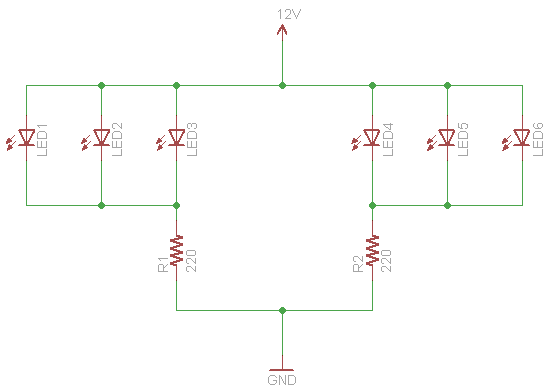

A guy asked me to repair the tail light for his **broken link removed**. It has six blue LEDs and judging by the atrocious wiring and electrical tape inside it's either non-stock or has been modified. The problem is that a couple of the LEDs are dead.
Since they're all the same age I plan to replace them all. He wants high brightness. I want to get them fairly quickly, so Digikey it is. They're expensive and have not much selection, but they're quick and convenient. What they have is Kingbright 5500mcd LEDs. Is 5500mcd bright enough for the job? Opinions?
The wiring was done like this:
Can/should this schematic be improved? What do you all recommend?
I would put a resistor in every lead of a LED it's not the money that will stops you from doing it
5500 mcd would in my opinion do the job

You can. With each addtional branch the LEDs will be dimmer (more voltage drop across the resistor). Adding resistors to each branch will alleviate this problem and they should be brighter. You could use a 150 ohm resistor in place of the 220 ohm and stay with the current configuration. This will allow your LEDs to shine at optimum brightness. If you choose to use a resistor in each branch, go with a 470 ohm.
I would think that in a situation where safety and reliability are high on the priority list that every LED should get its own resistor.
Note that I've never actually witnessed the LEDs-in-parallel-dying phenomenon where one LED hogs the current until it dies, then another does, then another, etc. But I've been warned about it enough times by folks I respect that just don't ever put them in parallel.
Maybe it's a belt-and-suspenders thing. :)
Torben
Separate resistors for each LED - using common resistors is probably a major reason why they have failed.

As Nigel as said and we keep saying to Tyro's who put LED's in parallel, it should only be done if all the LED's are voltage matched.
The easiest and most reliable method is to use one resistor/LED.

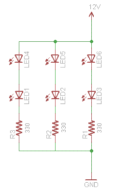

As it's 12V it's more efficient to connect two in series.
