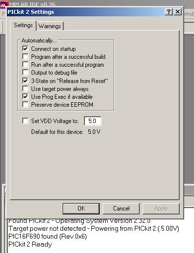

What happens in MpLab is you don't release the chip from reset after programming.
It's holding Mclr Low and then your program will not run.

I was going to add this to your other post in the section, and then found your comments here.
There is a little procedure you can follow that will eliminate this problem with the PICkit2 and LPC board.
When you are in MPLAB IDE, and have your chip (16F690) and programmer(PICkit 2) selected, click on the toolbar box "programmer". In the pulldown list, at the bottom, is settings. Click there, and you will see a box like in the attachment to this post. Check the box named [3 state on "Release from Reset"]. You will only need to do this one time.
This should eliminate any further problems with using the pushbutton on the LPC board. Since you are using HiTech C, be sure to include MCLRDIS in your configuration statement.
