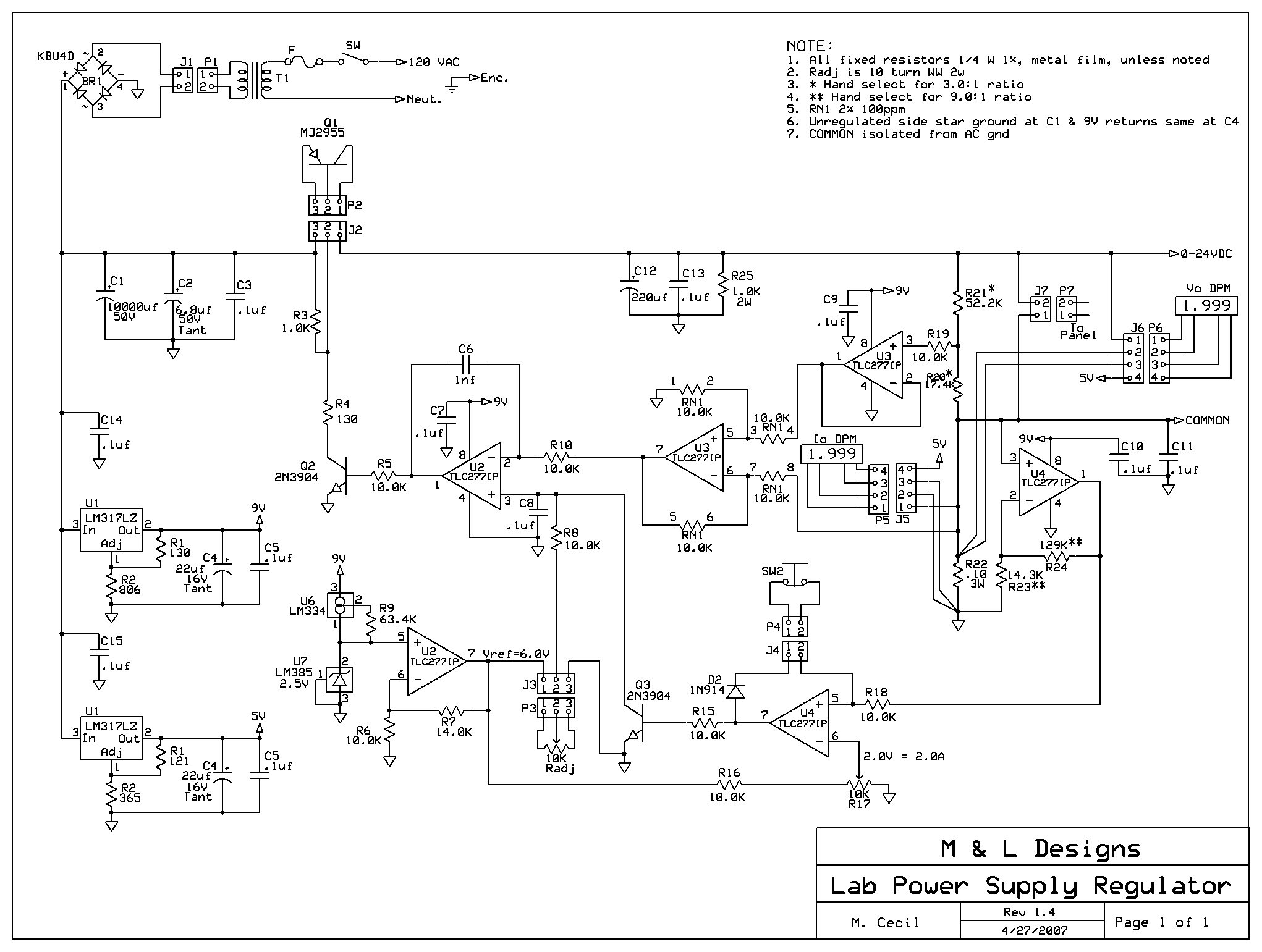

Last year I got around to building a replacement for my 20+ yr old noisy bench supply that lacked current limiting. The one I replaced it with is a hundred fold better in every respect; % of regulation, thermal stability, noise, etc. The schematic is attached. As configured, it is 0-24V (changing ratio of R20 & 21 to 4:1 will take it to 0-30V with the 6.0V reference), current limited and metered (LCD PM's); both voltage and current. If you have any questions, I'll be happy to answer them.
Edit: Marks256, I screwed up and posted an early, non-validated rev of the PS. If AudioGuru hadn't have posted a question regarding the efficacy of the design, you or perhaps others could have been led in the wrong direction. My apologies. The as-built that went to the board house is attached.

Hi MR Cecil,
What is the current rating of your power supply?
What is its transformer voltage and current rating?
I notice that the power transistor Q1 has a very low max base current of only about 30mA so if its gain is low then the max output current will be less than 1A.
Doesn't R4 get extremely hot when the load current is high?
