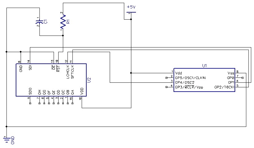

ok all put up a schmatic if I can draw one that is I don't know what you guys use for it though can you point me to the program ?
Here it is I didn't put anything on QA to QH but there's a resistor then a LED

I still don't think the code is working right because everytime I try to sim it it seems to only want to go to shift3 even if its a 1 in the carry so im not sure whats going on I gave the schmatic for you guys of what I have setup I don't know if its hardware or software maby you guys can help with that anyways I won't be home till 9pm eastern so maby when I get back if there is anything new all try it out like new assembler or a new schmatic im desperate to get this working right haha I think thats the problem or one of them is that it will never go to shift2 it will always go to shift3 even if its '11111111' as the string I don't think the btfsc is working right if I change it to btfss it goes to shift2 and no matter what will never go to shift3 and its the same reversed as I said before
