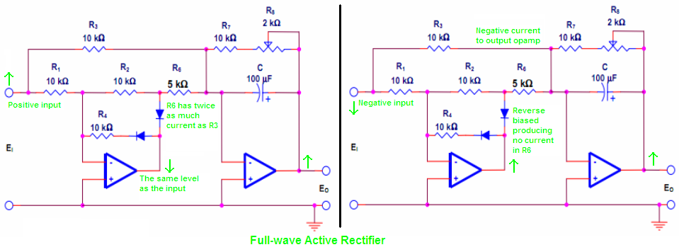

K kewl New Member Mar 9, 2011 #1 can anyone please tell the working of the circuit given in the attachment.. Attachments Document.doc Document.doc 42.5 KB · Views: 212
audioguru Well-Known Member Most Helpful Member Mar 9, 2011 #2 The full-wave active rectifier circuit works like this: Attachments full-wave active rectifier.PNG 48.1 KB · Views: 410
audioguru Well-Known Member Most Helpful Member Jul 16, 2011 #4 akilan said: Dear sir, You mean the in put is AC power and is DC Power is it Click to expand... No, it rectifies an AC signal input, not an AC power input. its output is a DC signal, not DC power. Signals have a very low amount of power.
