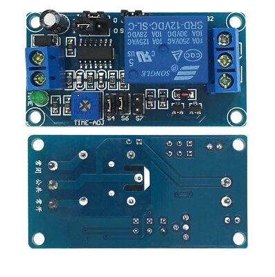

wiring a relay ( dual) to operate 2 electromagnets

I agree with crutschow. But, bluntly, the documentation is poor and innaccurate.
The module you've chosen doesn't have the circuit flexibility to enable the connections needed. It has a solid state output that places restrictions on how it can be connected to external circuits. The module crutschow recommended has relay contacts for an output, so its very flexible.
The two timers will have to be cascaded such, that the output of the 5 sec timer module will need to trigger the 15 minute timer, when the 5 sec timer de-energizes (or expires).
Will this mean that the 2 timers will be incorporated into the circuit containing the 2 relay board before the +20 V is fed to the boards 2 normally open terminals and hence remove any chance of a relay remaining active for more than 5 seconds but restore +20V after 15 minutes ?.
As I noted, the timer I referenced with the relay output, appears to allow the timing of both the on and off intervals, so that may be all you need.
The timer relay output would power your other module that controls the electromagnetics.

No. You need two timer modules for each uncoupler coil.
Why do you say that when the timer appears to allow control of both the ON and OFF times?
Won't that make a astable multivibrator?
Otherwise, one short timer and one long timer. The short timer triggers on rise of DCC output, the long timer triggers on fall of short timer.

Consider one like this for each output?
Connect to the output switched power in "delay on" mode, set for the maximum time you want the solenoid coil to stay energised, then connect the normally closed contact in series with the solenoid, so the power is disconnected if it stays on for more than the set time.

So here's how I think the modules will be interconnected. If it can be reduced to using just one timer, that's great.
In the simulation below, the 15 minute timer duration is set to 10 seconds just to make the simulation quicker.
