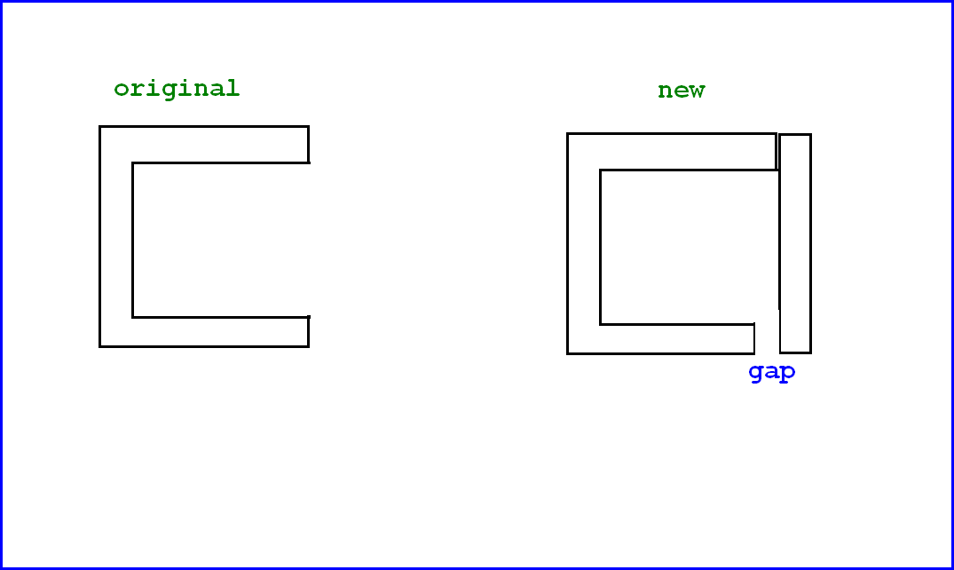

For an electromagnet, an increase in the distance between faces increases the reluctance which means less strength. So if the core as is has faces 2 inches apart and after cutting one leg off the two faces are 3 inches apart, the one with the 2 inches apart should be stronger.
If could somehow get the two faces to be closer together than you would have a better electromagnet. Say 1 inch apart. That should pick up smaller pieces better. If you cant do that, try extending one face outward toward the other somehow.
An idea would be to make a straight piece like the "I' of the original core that is only 1/2 as long as it would take to go across all three faces. Then it would go across only two faces, and if you make a gap of say 1/2 inch at one face then it should pick up smaller pieces better.
something like this:
             gap
(i might have to come back and draw this out better)
             gap

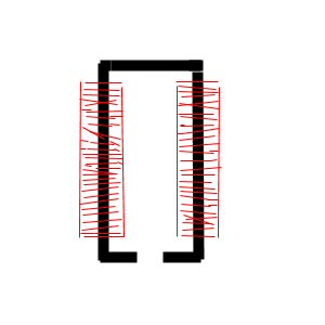

You didn't show where to put the coil. How bout something like this?

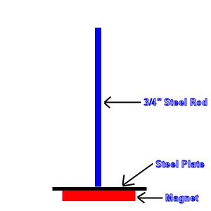

You're forgeting one very important factor. The bottom of my well is filled with about 5' of rusty metal flakes that have fallen off the inside of the casing. This well was drilled in 1959. All this may be moot now. I picked up a permanent magnet today that I am sure will lift that weight with no problem. It's off of a huge speaker. It's 6" in diameter and 1" thick. I tried to lower it down with my winch with 15 lbs. of dumbell weights on it but as soon as it reached the water the weights were not enough. The magnet was too strong and just stuck to the casing. My next plan of attack is a flat round peace of steel 7" in diameter with the magnet on the bottom side and 120' of 3/4" steel rod (in 20' sections) bolted to the coenter of the steel plate.
How about making the plate from plexiglass?
or even two sheets separated by standoffs about 1 to 2" long?
Put holes in the plastic around the outer edge so water can get past more easily?

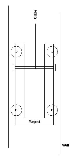

To keep the magnet from sticking to the well casing perhaps you could use a trolley mount, something like this:
