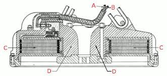

Lifting magnets typically are cup-shaped, with a central core. The cup rim forms one pole and the core forms the other. Like this:
https://encrypted-tbn3.gstatic.com/...oWuSge4Rh9peMZIufAgb0-Mjy5LYxKObpaGOWpzm4vVl5
Tried to stay out of this thread. The lifting type or for that matter a 'magnetic chuck' for holding steel to a surface grinder are made the same way. And the microwave oven transformer with a coil in the middle is the same basic thing. The center leg of the "E" (or M as the op described it) is one pole. The outside legs make the second pole. When the object to be picked up is across the center and at least one of outside legs the electromagnet is complete.

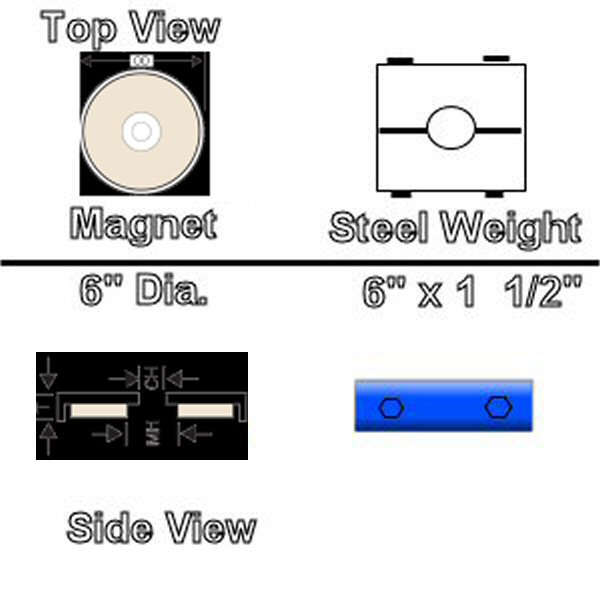

This is the magnet & weight that's at the bottom of my well. They are not connected. The cable goes through the weight and connects to an eye bolt on the magnet. The weight just sits on top of the magnet cover. I have no clue how they got disconnected from the cable or what position they are in. I only know that I have to get them out before I can continue deepening my well. The magnet is not very strong or heavy, but I will need the electromagnet to be VERY strong to pull the 6 lb. weight up. The well casing is 8" steel pipe. To keep the electromagnet from sticking to the casing it will be inside a short piece of 7" PVC pipe.
