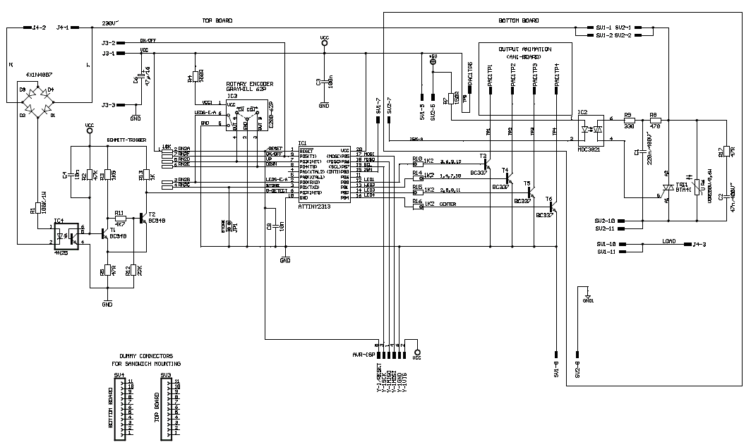

Hi bigal_scorpio,
if you want a circuit well suiting your requirements you could refer to my design. The device has been tested on AC motors of 2.5KW without any triac misfires.
The triac used is a bit overkill since it can handle up to 40A, but I preferred the BTA41 because it's fully isolated.
The circuit corrects for mains frequency changes between 46 and 54Hz automatically thanks to a Schmitt-Trigger circuit with very short pulses for the input of the microcontroller.
The output circuit is standard. You might omit the snubber circuit for the power triac and replace it with a VDR rated 275V/0.6W if your motor has little power (max 250W).

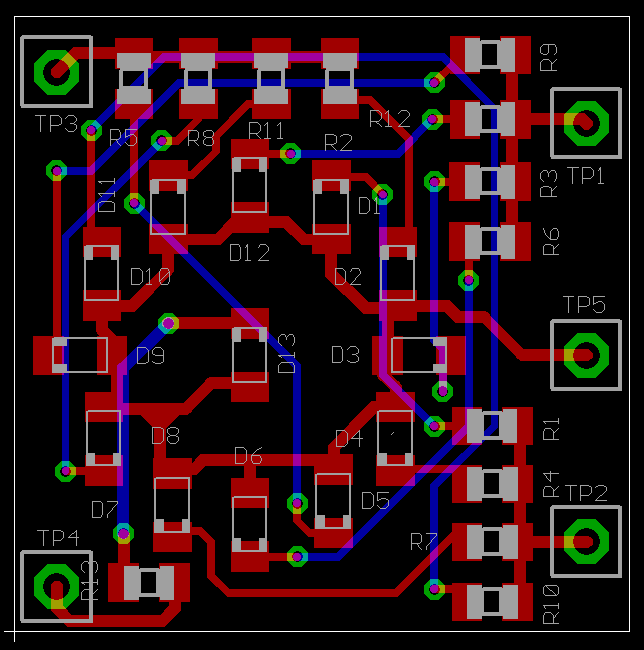

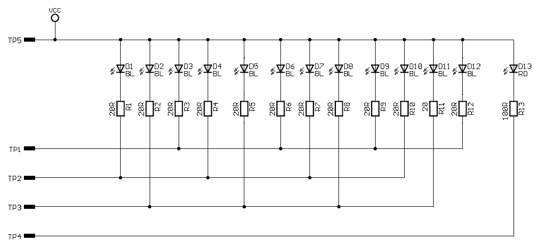

An option is the animated LED circle indicating motor rotation with increasing speed. If maximum rpm is reached (full AC output) the 12 blue LEDs (arranged like a clock face) extinguish and the center red LED illuminates.
For rpm adjustment I used an optical rotary encoder (Grayhill 62P) to make the operation of the device fool-proof. (Thais even destroy pots by overturning them. :eek:)

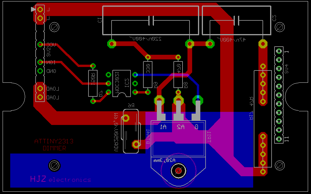

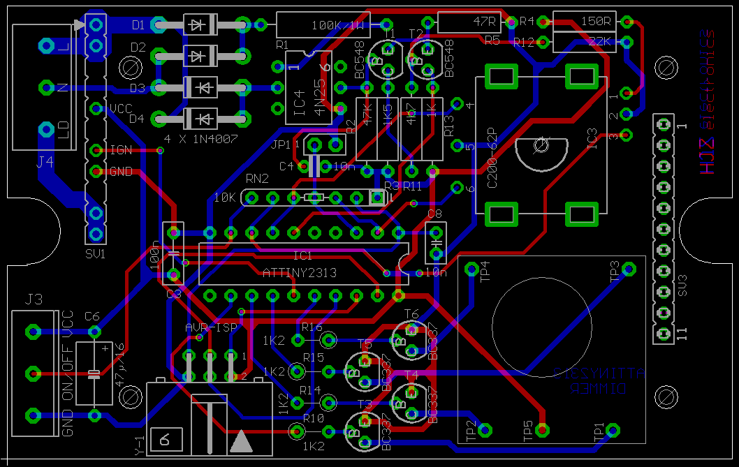

Here are the schematics and PCB layouts. I used two PCBs mounted as a sandwich to fit into a standard US wall outlet box.
The hex file for the ATtiny2313 will be provided if you decide to use that circuit. If you don't posses an ATMEL programmer I might ship a programmed chip to you compensating for the chip and shipment.
Boncuk
