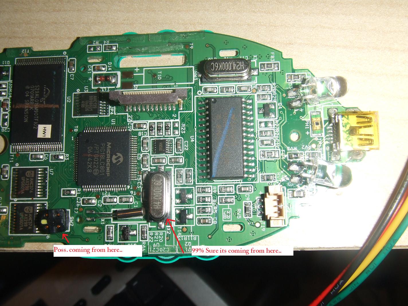

I have a Logitech Harmony remote control that has stopped working, everything appears to work apart from the remote isn't actually blasting any signals to my devices..
When I shake the board I can hear quite an obvious rattle.. from what I can tell its coming from the crystal marked in the image (I'm right in thinking thats a crystal? )
Would a damaged crystal rattle? and is there any way to test it with a multimeter ? (I don't have an oscilliscope or anything fancy like that..)
It definatley sounds like its coming from either of the points marked on the image, It's hard to tell but i'm 99% sure its coming from the crystal.. I'm not even sure what that other thing is!!
Any help would be really appreciated as I've only done pretty basic stuff before!
Many Thanks

Ok, forget all that... its the second item I marked, not the crystal
I just looked further and underneath the black plastic on that part (it's like a removable cover) there is 4 pins with a ball bearing sat in the middle.. I have no idea what that is!
It looks like a switch to me. It is labeled SW2 on the PCB. It should "click" when you press it, but be sure you know what it does before you press it.
Would this be some kind of tilt sensor? I am not sure though why a remote would have this.
It appears so.. when picking the remote up it turns on and glows.. so I guess thats what it's for.
