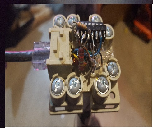

1) PIC .. only 1 sensor on 2 wires ... external voltage controller and data port connection on the catV

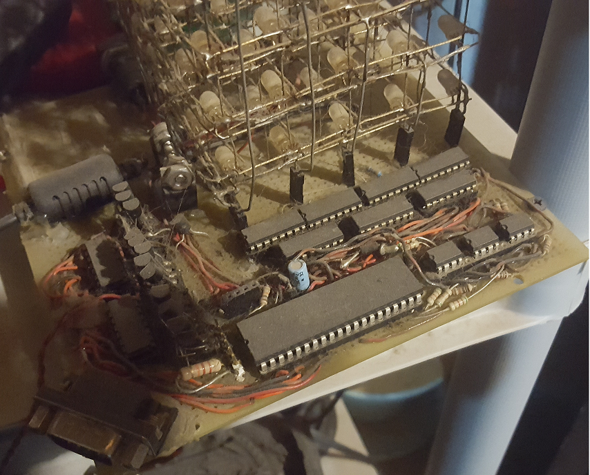

3)PIC .. lots of channels needed to run each led individually (5x5x5x3 # of switches being controlled)
