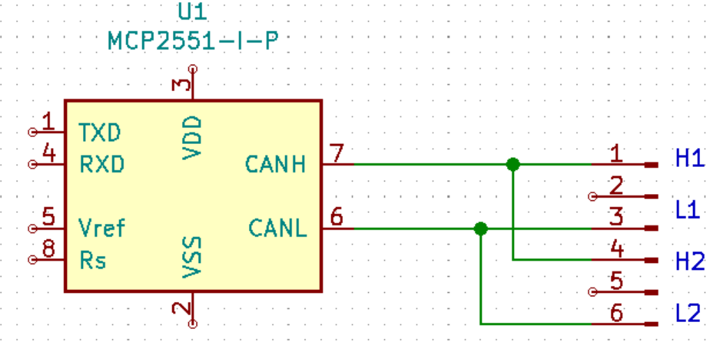

Please consider steering electronic control unit (ECU). It has 6-pin CAN connector.
CAN L pin is connected to another CAN L pin in this 6-pin connector.
CAN H pin is connected to another CAN H pin in this 6-pin connector.
What are the reasons for above connections?

Another possible reason is redundancy
This makes sense to me. This is probably the reason. There are two wires connected to CAN Transceiver CAN L pin and two wires connected to CAN Transceiver CAN H pin. For example, if one of the CAN L wire is cut, CAN communication will be unaffected because you have the other CAN L wire.
The question is how will be system detect that one of the wires is open circuit so low severity diagnostic can be raised. I say low severity because you still have the other CAN L wire.
Also, is there some standard or Functional Safety requirement this wiring configuration or two CAN ports in a Electrical Power Steering (EPS) connected to each other.

I agree. I didn't clear state my questions. On March 26, 2022, when I asked this question, I meant each CAN port in the ECU is connected to it's own CAN Transceiver.
In this question, both CAN ports are connected to same CAN Transceiver as follows:
That is done to reduce the need for splices in the wiring loom. Splices in the wiring loom can be very labour intensive to fit. If each wire goes from one module to the next, that eliminates the need for a spice within the wiring loom and leaves only the connector terminals.

Is splice not needed because adding a second wire to a signal like CAN Low increases the length of the wire?
It's not length, it's the number of connections.
Assuming that there is a wire from A to B that this module has to be added to, the method with a splice would be:-
1. Wire from A to splice
2 Wire from B to splice
3 Wire from splice to module.
If there are two connections on the module, then it will be wired:-
1. Wire from A to module
2 Wire from B to module.
Obviously that would apply to both CAN-H and CAN-L
