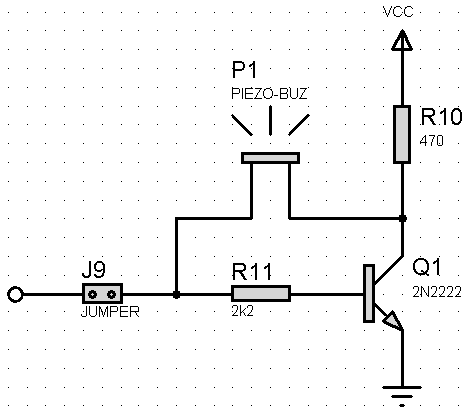

Why this strange piezo-buz circuit?
flat5
What is the reason for doing the circuit this way?
I can't see it working, not without something to bias the transistor on slightly.
That's what I thought. Either the piezo element has a shunt resistive component, or bias current is provided through the jumper.

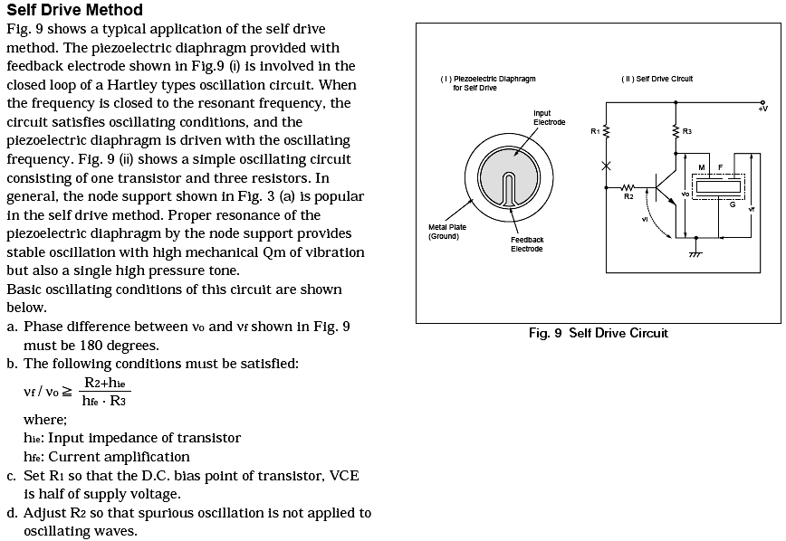

EDIT: Figure 9 in **broken link removed** from Murata has a similar circuit.
The circuit was taken from the Proteus v7 samples.
Here is an excerpt from the Murata PDF.

Murata's schematic of the oscillator for a piezo beeper uses a piezo with a 3rd electrode, the feedback electrode. The feedback electrode is out-of-phase to the main electrode (it is a Hartley oscillator) so the transistor has positive feedback.
I think it automatically oscillates at the loudest frequency of the piezo/helmholtz cavity.
