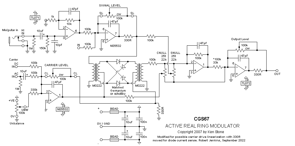

I am using this circuit without the CNULL and SNULL pots and I get extreme carrier leaking to output when I use diodes other than LEDs. LED don't cause this problem and it is silent as it should be when there is no input sound unlike other diodes. Why I get this problem with Germanium and Schottky diodes but not LEDs? All diodes are matched carefully.
Also modulation seems like not happening with other diodes and all I hear is distorted voice with carrier leak. That means It will probably not be any good if I add CNULL pot ant try to negate carrier leak.
I used tl074 and tl072 for this circuit. Not that it matters just saying.
That circuit looks wrong to me...
The carrier drive amp feedback is taken from the wrong place and it cannot regulate diode current; it will go from nothing to clipping over a tiny range, no linearity or proportionality to the input signal.
Try connecting the carrier opamp output direct to the left transformer centre tap and put the 330R resistor in series with the ground of the right transformer, then pick up the carrier level control feedback from the right centre tap.
That makes the feedback actual current, and should allow the carrier gain to directly control the diode current, with it be proportional to the input signal, all the way down to near zero. It should make it far nearer linear.
A carrier null pot is also pretty essential with that type of circuit.

Are there any other changes needed to be done in order to cope with the 750 ohm 3400 turn transformers I got as a mistake. I actually used 150 ohm resistors instead of 330 because I thought they were for preventing the op amp from shorting and it wouldn't matter much.
"pick up the carrier level control feedback from the right centre tap." how I do this?
The right hand end of the "CL" pot would connect to the centre tap of the right-hand transformer, rather than the left-hand one, so it is sensing the voltage across the [moved] 330 Ohm resistor than now goes from the RH centre tap to ground.
The rest should be OK, I think; it's trial and error..
Is it something like this? Maybe other diodes than LEDs are not working because diodes get saturated as you said and they stay open all the time.
Are these messages contradicting each other? Should the carrier op amp output go to left or right middle tap and if it goes to right what left middle tap should go, is it like the second one?

I have never built one of those but I have designed an awful lot of gear over the years, and that part just seems wrong to me, as it was trying to control voltage linearly which meant the diodes would never conduct at low carrier levels, messing up the linearity.
Sensing the current through the transformer winding and diode combination should mean it controls current in proportion to the carrier level, so hypothetically a more linear input.
Whether it works better or not is another thing! I'll wait for you to try it out.

Re. the double opamps: The first TL072 on the output is a unity gain inverter.
It allows the "null-ing" signals from the two null pots to be mixed to the input of that and the input of the next stage, so by moving each null pot end to end both the level and the phase of the signal added in can be adjusted, to find the point that gives best carrier or source cancellation.

I applied the changes. It made the carrier leak worse and introduced signal leak as well. And I can hear carrier leak with LEDs too. But with the other diodes there is some modulation which wasn't there before I think. Now I will install nulling pots and see if I can get it to perform well. btw I realised when I was doing changes that I connected signal level pot directly to op amp output instead of across 330 resistor that was connected to op amp out. Maybe that was why it didn't worked well at first.
Nulling pots made it better but there is still some considerable carrier leak that I can't null with pots.
I should try reverting it back but before that I will wait for your reply.
The diodes I am testing all have 230-231mV voltage drop. My test device cant measure difference of 1mV or lower accurately.
Also LEDs still produce sound that is at least a magnitude higher in volume than other diodes which was my main question in this topic. It is interesting.
The reason why other diode didn't work at first time was because the carrier gain was to high and carrier pot should been almost at minimum side. Leds did not had this issue since they had more voltage drop. Now I reverted the changes and it still got the carrier leaking issue. I am so stupid it was working very nice at first.
Last edit: I went back and fort with your changes and original. First of all I found that the 330 resistance doesn't matter if it is there or not. It doesn't effect even a little bit for all of them. Your changes makes all diodes easier to get modulating but it increases leak. Original carrier pot is more fiddly to get going for small Vd diodes but it got less leak. My final answer is that I played on this too much and tried fixing something that did not need fixing and now I will always have leak no matter what I do. This is my punishment for being greedy, it is not first and it will not be last. I will probably scrap this and throw all in garbage after my obsession advances.
Try swapping the connections to the ends of one of the transformer windings? The leakage is possibly from inter-winding capacitance, or otherwise something to do with the overall circuit layout, grounding etc.
