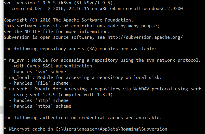

Attached is the version of svn client I'm using.
The answer is in google. There was no tmp folder under .svn folder. I manually created tmp folder and then svn update command worked.
I'll report this bug to SlikSvn.
