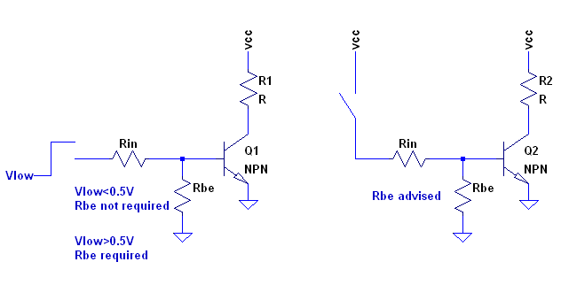

I was adviced by an engineer that in addition to a resistor one of its legs connected to Vsource and second to Base, to connect another resistor from Base to ground.
1. Why is it recommended?
2. Should the resistor be very large so the Vsource (MCU GPIO pin) wont source large current?
Thank you.
How exectly does it ensure that the transistor is in cut-off?
The present Base resistor is 300ohm (The base-Vsource resistor).
Thanks.
In two ways, first it discharges the base/emitter capacitance, and it forms a potential divider with the series resistor - not all outputs feeding it may go low enough to switch it off, by adding a potential divider this ensures it will.

300 ohm resistor to base ONLY - logic feed to resistor is 4V when HIGH, and 1V when LOW - so transistor is always ON.
300 ohm resistor to base, 300 ohm resistor base to emitter, input voltage is divided by two, so transistor turns OFF when LOW is supplied.

Yes, that's divided by two 'sort of' - but not really, because the Vbe of the transistor prevents more than 0.7V across the lower resistor. In reality it just bypasses some of the base current.

the current that flows through base resistor, splits to two:
1. BE current
2. Base-GND current.
Below is a simplified view of when Rbe is required.
The fact that the base is connected to the junction of the two resistors does not mean the resistors are not in series. They are.
In series = same current goes through them.

What about when Vbe<0.5V? Then, Ib is essentially zero. The resistors then just act as a voltage divider.

The need for a base resistor to ground (particularly a high valued resistor) might be considered if the source is disconnected at times, in which case the transistor input is floating and the gain of the transitor may result in some small amount of collector current to flow randomly and/or sporadically due to noise pick-up. Since the base is connected to an "MCU GPIO pin" it may at times be configured as an input pin rather than an output pin, in which case, the transistor input may be floating.
Otherwise, generally, a voltage divider is used for biasing of the transistor as in an amplifier, or as stated earlier, for turn-on/off level control as needed.
