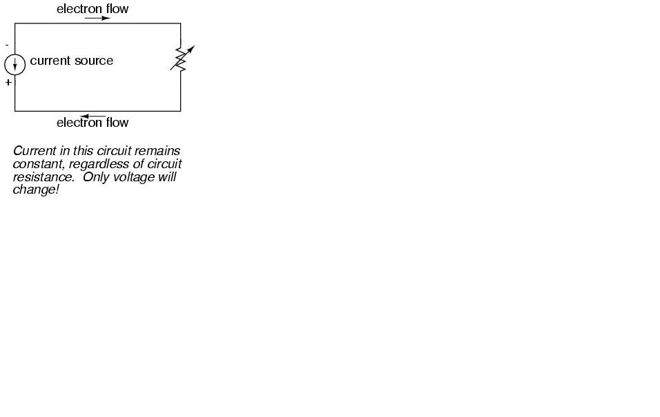

I've seen many pictures that depict the following diagram of the attachment; and I always see them flowing from - to +. Note the arrows.

The diagram you attached clearly states "electron flow" as going from minus to plus, so it's correct. Did you notice the current source on the very left of your drawing? It's a circle with an arrow showing current direction which is the OPPOSITE direction (that is, going from plus to minus) as electron flow.
That's the convention for schematic symbols including transistors: "current flow" is defined as plus to minus, even though we know electron flow is the opposite. "Current flow" is a mythical entity that flows the reverse of electrons. I read someplace that Ben Franklin was the guy who first declared which way current flowed way back when..... and with a 50-50 chance of being right, he got it wrong.:D maybe that's just a legend, but I remember reading it.

Yes bountyhunter, I already knew that electrons flow from - to +. Just to prove it, I showed the diagram in the attachment that I found online. Yes, again, I saw the arrow on the far left and I don't think it shows current in the opposite direction, but that there simply IS current flow.

You are completely wrong on that. That symbol is a standardized schematic symbol for a current source which BY ACCEPTED CONVENTION always points in the direction of "positive current flow". That's the symbol, that's what it means, been that way for as long as I have done electronics (about 45 years).
You will also see transistor and diode schematic symbols follow the same convention: arrow head points in the direction of positive current flow, the exact opposite of electron flow.
