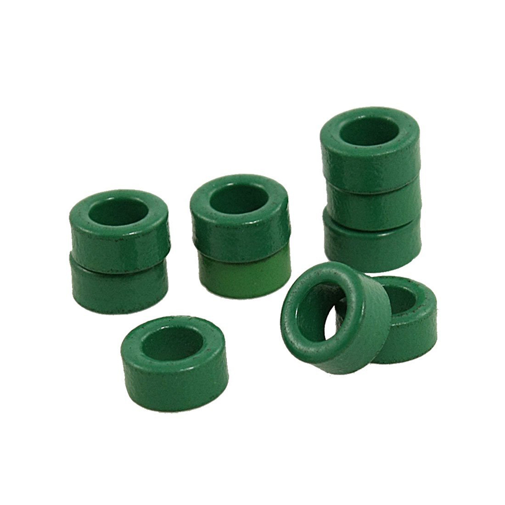

I bought some Green 10mm x 25mm Ferrite Toroids from China.
1 Green toroid with 11 turns of wire on makes a .5 mh choke.
2 Green toroids taped together with 11 turns of wire makes a 1 mh choke.
4 Green toroides taped together with 11 turns of wire makes 1.8 mh choke.
1 TV toroid white snap together plastic case with 37 turns of wire same physically size as 1 Green toroids makes a 8 mh choke.
2 black natural color toroids taped together 4 times larger than 1 Green toroids with 11 turns of wire mades a .2 mh. Larger is NOT better.

Will higher flux make a higher mh choke?
Any suggestions where and what to buy I want to make a 26 mh choke?
