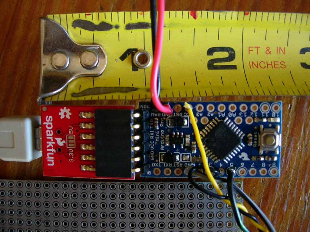

I would buy my first Arduino Micro from SparkFun.
Use it for initial learning and to check the integrity of the USB connection between the IDE and the micro. You can buy cheap Micros or Minis that become a wired-in permanent part of a project from the Chinese knockoff suppliers, but I would always have a "genuine" board around for debugging.
Two ways to go with the knockoffs:
Get one of these, and many of these. This uses one "programmer" (really a USB to serial converter) and lets you use simpler (lower power consumption) modules.
OR
Just buy these. This has the USB interface on each board.
I have used the knockoffs successfully, but initially had some Windows USB driver issues with them where I had to obtain and install drivers that were not included in the IDE download...
You can get similar problems with all units, not just clones.:eek:
USB functionality/drivers depends on the USB hardware implementation. On the clones I bought the USB chips were better than the USB chips on the 'genuine' boards.

This happens to be the one I needed to put in a low-power sleep mode for 99.99% of the time. It is a prototype controller for a high-altitude balloon beacon transmitter. It wakes up periodically, keys a transmitter, sends Morse code flight parameters and an ID, and then goes back to sleep. Literally took less than five min. to wire up, download the first iteration of the code, and test the prototype.
Also an example of how the USB-to-serial unplugs from the Arduino after you are through developing the code...
