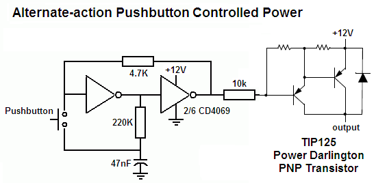

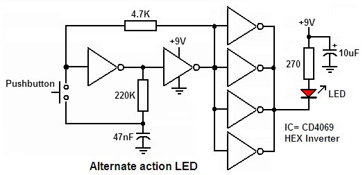

What are you switching? If it is DC then an alternate action circuit will use a momentary switch and alternate from high to low to high to etc.
