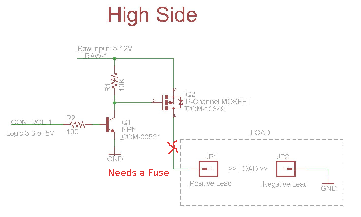

My DIY designed green house watering controller (PIC24FV32KA302) has worked pretty good over the years , but last Friday, its LCD was blank …. seems my design was missing a vital component .. A fuse ! … the 12v pump had seized ( impeller was blocked ) when the timer fired up the IO pin the 12v battery dumped all its amps through the MOSFET and shorted the pumps winding ,as the pump is underwater it didn’t burst into flames. This destruction condition lasted till the switch died … Pump was about 150 Ohms, but finished up about one ! The drive circuit similar to this ! Lesson learned..
It's best to place the fuse at the 12V input, not the circuit output, so it protects if anything fails in the circuit also.

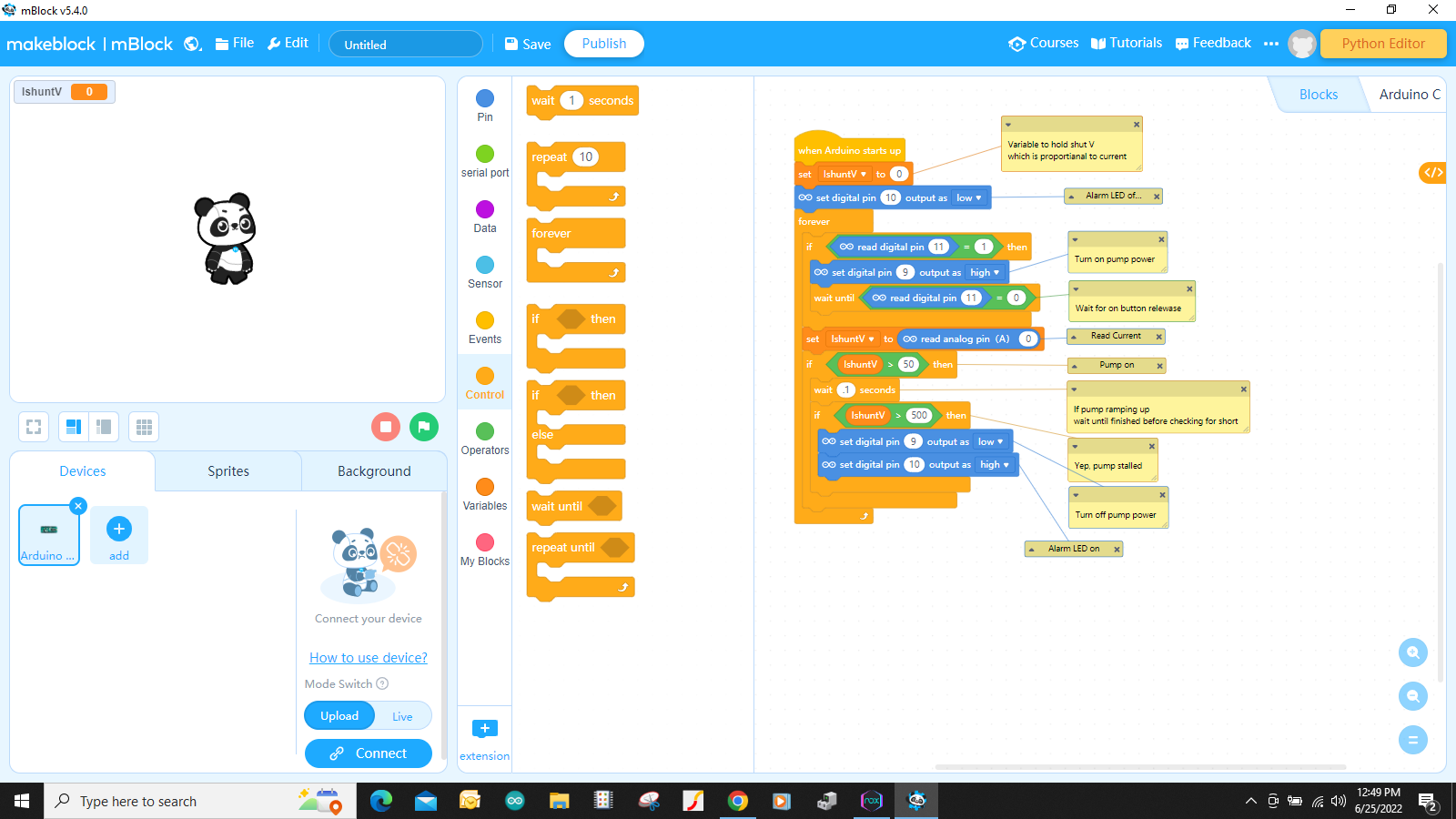

Very simple ATTINY85 to detect pump stall, protect everything.
Code simple (this basic, not complete, starting point) .....
mBlock, takes your block code configuration, as shown above, and generates
Arduino like code to run on Arduino or an ATTINY family part.
Could even read pump heat, relative to ambient, to see if it is getting ready to fail.....
Just a thought.
Regards, Dana.
Thanks ..I have not been entice by the Arduino maker nation, ( I am #1 PIC and 'C' fanboy ) but a current monitor is a good design feature perhaps some feedback on the high side switch may work..

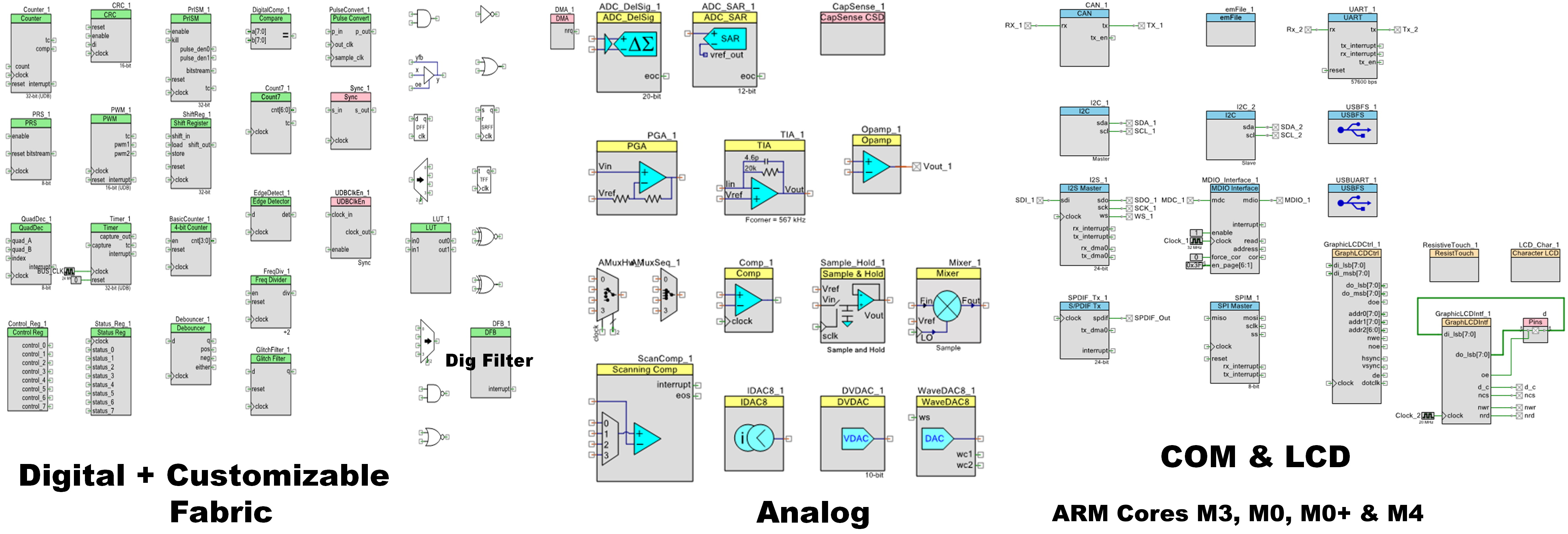

If you are a C guy take a look at a single chip solution with a lot more capability for future stuff,
routable, ability to create custom onchip facilities, DSP, State Machine, and of course all the analog
onchip resources (many multiple copies) -
And community has done CPLD,. 74HC, DDS, LUTs and others for it as well added into its
fabric.
Like having a protoboard and LSI, MSI,....cabinets of parts all on one chip.
Including RTC, die T sensor....
Regards, Dana.

I appreciate your information , I am a very amateur C guy.. and way past my 3 score and ten , only half a dozen grey cells left ... That said your picture looks very interesting , Cheers

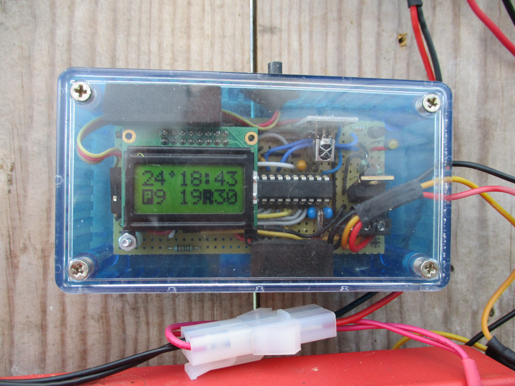

Interesting... Does it use switches or push buttons? Schematic?
This project is way back in my win XP and Eagle days( 2008 ). I no longer have the files well cannot find them :( The controller started with a sw and 3 {up /down/next buttons }, the last version used IR so I could seal the box , moisture not good for copper strip boards :)
