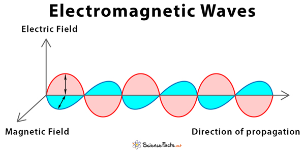

I need to know what is the difference between an electromagnetic wave and a radio wave?
I came to know that frequencies below 3 kHz are electromagnetic waves but are they photos or something else?
If an iron core coil rod is connected with a frequency oscillator and AC is applied to the coil from 100 Hz to 2 MHz then till 3 kHz the coil will behave like an electromagnet but not after that?
After 3 kHz, photos will radiate from the coil in the form of radio waves?

Electromagnets generally done with DC, eg. attract/repel depending on polarity.
Applying AC is a continuous train of attract/repel and not useful as an electromagnet.
Regards, Dana.
The frequency has nothing to do with whether the radiated signal is a radio (electromagnetic) wave or not (in the form of photons).
Any AC current will radiate electromagnetic waves.
Whether that wave is practically detectable, depends upon the frequency, current, and configuration of the wire containing that current.
Any current also has an associated close (near) magnetic field which is independent of frequency (going down to DC).
