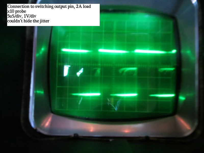

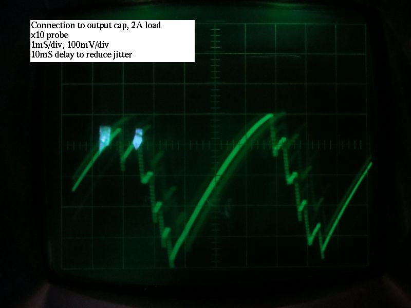

I checked the waveforms again. What I had cursorily looked at before and taken for the switching waveform being rounded at the corners, actually is huge 100Hz ripple. The actual switching current, and voltage on the chip's output pin, is a fairly healthy looking squareish wave, with a lot of jitter. I got it stable by setting a 10mS delay on the 'scope.
It's as though the switcher is taking the bit of ripple on the input and amplifying it by maybe 10 times.

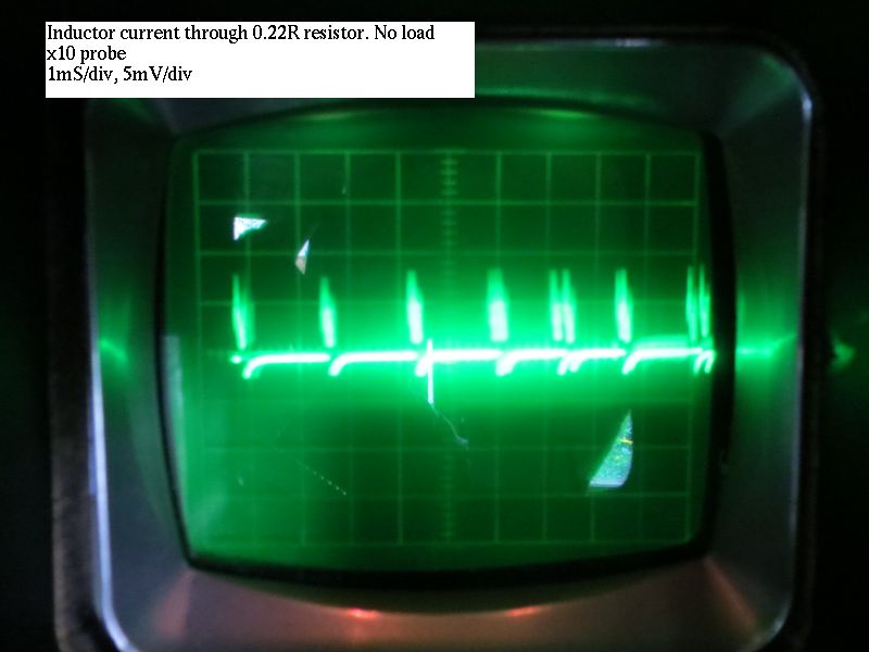

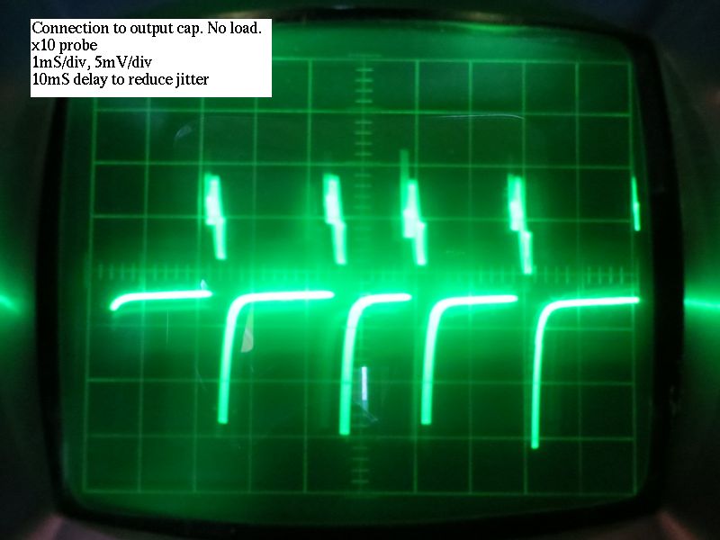

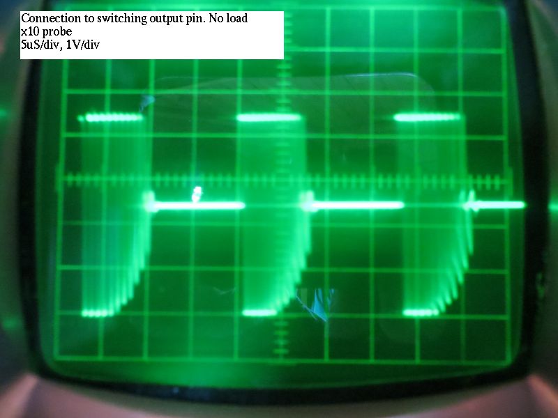

Right, scope photos attached.
These were taken with the meter showing a big chunk of AC current in with the DC. However, after I took these I disconnected the little voltmeter module I'd been using to monitor the voltage, and it quietened right down :banghead::banghead::banghead: but still dropping significant voltage. The extra muck that was in there doesn't seem to have made any difference to that happening though. Up to about 2A it only loses a couple of volts, but at 3A the 25V output drops all the way to 13V.

Ring city.
None of the traces look really bad, except the current through the inductor at load, does your scope go fast enough to make that green haze into a visible wave?, my guess its either really bad ringing or maybe the circuits oscillating where it shouldnt, or its just the pulse width varying a lot filling the screen with the trace, try triggering the 'scope using the other channel as the trigger connected to the switching waveform voltage (assuming its a dual trace 'scope).

That one pic looks like sub harmonic oscillation. That could be caused by the wrong type of inductor. Try another inductor even if it is rated lower, and keep the current lower. You really should get a better sourced chip to try too though.

I had a hard time taking the photos due to the amount of jitter - 10mS delay helped steady the waveform to look at, but it still moved around too much for the camera.The last pic I thought it more useful to show the whole envelope, not just the switching waveform, which doesn't actually look bad. I'm not sure testing the current whilst triggering on the voltage is going to help since the timings are the same.
