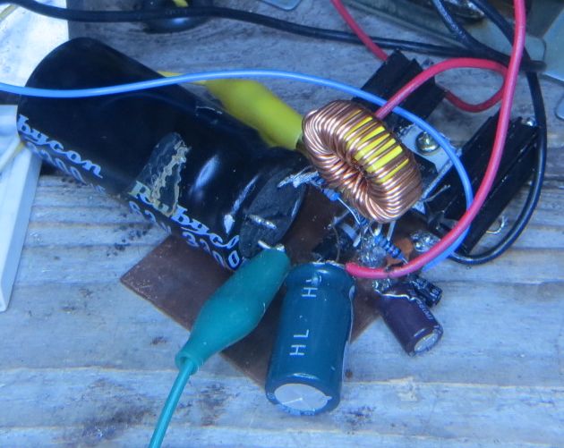

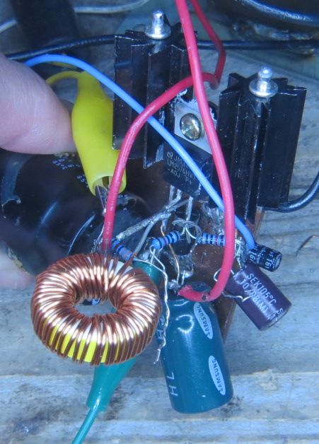

I attached a schematic and some photos. There's an extra cap in the photos, I thought extra de-coupling might help (it did a little bit)

Looking at that choke it looks like theres a white band on one side, if so its a powdered iron core, not necessarily a problem, however some are designed for dc noise filters and are not particulalry good at high frequencies, loss will be high, if the core warms up that'll be the case.
If its just the sound it makes thats an issue and the converter works well otherwise dip the choke in electrical varnish, or spray it with some lopty spray if you can still get it, trannys in commercially made devices are nowmally plastered in the stuff to keep them quiet amongst other things.
Gosh, glad I took that side-view(ish) photo then!
I didn't know about that kind of colour marking. Could explain why the waveform is a bit rounded at the top and bottom though. 52KHz - I didn't think that was a particularly high frequency. I'm not bothered about the audible noise - it's fairly quiet when it's working properly. Actually it's a good thing because I can hear when it's not right. It does get a bit warm though.

Is there anything I can do to improve things with the choke I've got? Like putting a small efficient inductor in series with it perhaps?
I'd say yes thats most likely the reason why the corners are rounded, iron powders often have one end coloured that how I spotted it, a better material for the application would be N87 ferrite, either a ready made choke one or roll your own from something like a etd29 core or maybe a bit smaller.
The listing does say the choke is intended for the outputs of switchers, ie not necessarily the storage inductor, doesnt mean to say it wont do the job, if the temp of the choke isnt mad hot it might be ok (heat is also made by dc resistance which in this case is 45mOhm so that wont be much), measure the current of the circuit with a small load, change the inductor for a known good one, the diffo in power used is what is being lost in the lesser inductor, or you can work it out from the datasheet specs and compensating for the power in the small load if your a mathermatician (I'm not).
The noise is most likely an envelope riding on the 50kc switch freq, like I said dipping the core in something thats an insulator will quieten it, make sure though the noise isnt summat bad, looking at the current waveform using the sense resistor idea is a good start.

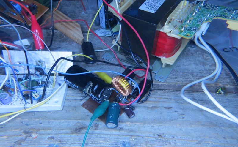

Hello there,
Please tell me that you are not using one of those little white solderless plug boards for anything that is related to power conversion.

Add a solderless plugboard and expect all kinds of strange and seemingly unexplainable problems. Get rid of said board, see problems go away.

Mr Al, the op posted pics of his prototype, looks like they are manhattan style or 'dead bug'.
I have put together converter circuits on breadboard, ones that operate at low current that is and they have worked reasonably well, however plugboards have given me all kinds of weird goings on, quite right in that these things are not so good for certain applications. I tend to use a piece of copperclad for the ground and solder to it, that improves things a bit.
If you 'scoped a switcher running in a breadboard you'd get loads of stuff you dont want, esp while the supply is freewheeling.
Wondered when you'd show up, Mr Al!
The switching prototype is soldered up as dr pepper points out, dead bug style. All the stuff on the breadboard is linear, and I've been getting enough weirdness with that as it stands!
