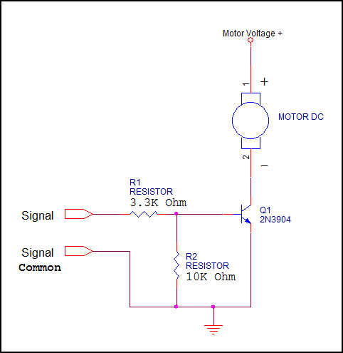

The attached is the circuit I used with the parallel port outputs when I was screwing with them. The base resistor could likely even be 1K but I used 3.3K. Using something like this the motor is On or Off with a single direction. Now if you build a small H Bridge your motor would have Forward Off Reverse using two bits from the port. The transistor can be a 2N3904, 2N2222 or a BC547 as just about any PNP switching transistor should work as configured in the drawing.

Actually, I tried building an H-bridge when I first started the project (i actually didn't know what it was called when i built it) and I came up with a design almost identical to the one here:
Before answering my questions below, can u tell me if the circuit above is built correctly? Is it supposed to work? If yes, then the problem described below is probably due to some error I have committed. I hope you can point it out to me.
I thought that using only one kind of transistors would save me a lot of headache. My circuit uses NPN transistor 2N3904. Whenever I turn A high (at two base pins), only 70 mA flows in one direction. When I turn B high (not forgetting to turn off A), 70 mA flows in the OTHER direction. So, basically, my circuit works, but the current is too low, even when measured at ground (i need at least a hundred milliamps for the DC motor).
I have been trying to find out why the current is too low. Note: each of A and B is connected to only one data pin of PP (what i mean is that both base pins at A are supplied by only one pin of PP. the same goes for B.) Do you think this is the reason the current to motor is too low?
(another thing: since LEDs are basically diodes, in general, is it ok if i use LEDs in place of some diodes like the snubber diodes they use in H-bridge circuits?)
Thanx guys!!! :)
I hope ur not bored yet!
Hi Ya
Nope won't work in a nutshell. When building a H bridge we use complimentary pairs of transistors NPN/PNP like a 2N3904/2N3906 or 2N2222/2N2907. Give this article a read.
To function correctly an H bridge needs to have the transistors driven into saturation which is a way of saying maximum conduction to where the voltage drop between the emitter and collector is as close to zero as we can get. Also I should point out that a combination like the 2N3904 & 2N3906 are not the best choices for a H bridge but will work OK. You want basic and works and they will work.
Nope, can't use LEDs. :) Even though in a sense of the word a LED is a diode it isn't what we want and doesn't have the characteristics we want. The diodes are optional in a real basic circuit anyway.
I would try using the simple one transistor circuit I posted a few post back connected to your PP and see if it drives your motor. Then I would move along to the simple H bridge using a 3904 & 3906 just to see how it works. Working off the PP I would use 3.3 K Ohm base resistors before trying 1 K Ohm.

Now that I read the article I have a clearer idea on how transistors work. The author of the article also explains that, under load, the transistors 2N3904/2N3906 are a bad choice for an H-bridge: "And the low-end 3904/3906 transistors were complete failures. Up to 2/3 of the power that should have gotten to the motors was wasted in the transistors of the motor driver h-bridge."
This explains a lot to me. Now I will do some more research and experimenting. Thanx again!! :)
