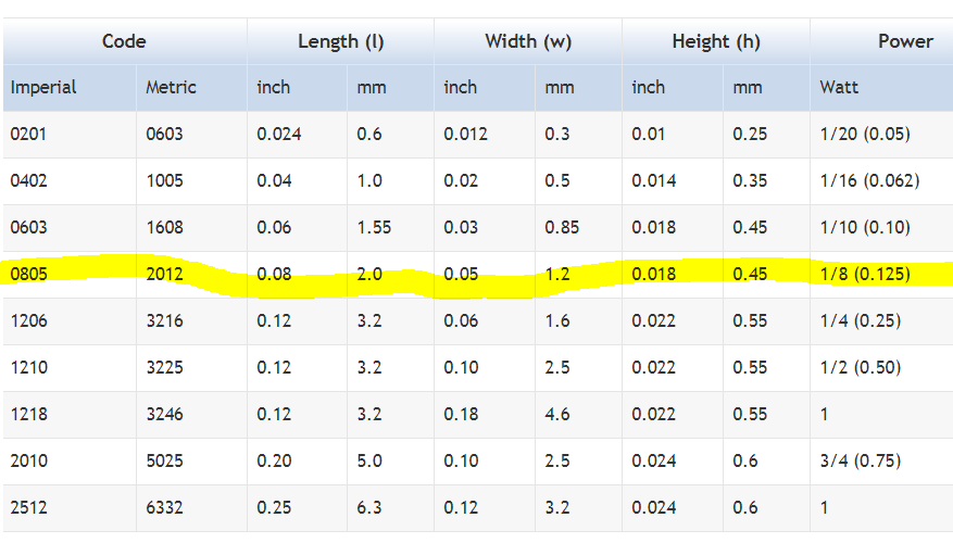

What part is 470P K?
"C" is usually used to indicate a capacitor. "P" stands for picofarad (pF). It is often lower case. "K" is a tolerance. In this case +/-10%.

So I should look for a SMD component that has those specifications and approximately the physical dimensions that I listed? I'm just asking in case there is a way to simply map "470P K" to a specific part.
There are only a few standard sizes. It is probably an "805"
