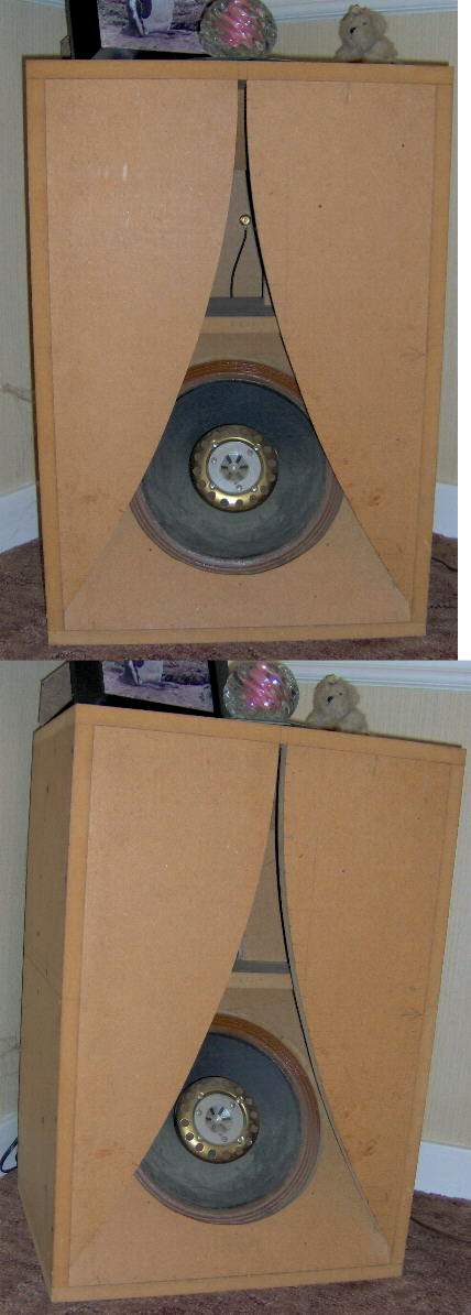

Here is one of my 3/4 Scale Karlson Cabinets.
Custom Made Coaxial Speaker Gives GOOD SOUND and BASS.
