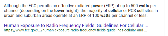

What is, Fairly high power? 100 watts? 500 watts?
What is short distance? 5 miles? 10 miles?
The earth is not flat anymore. If a distant signal does not bounce off the ionosphere then it is not received on earth, it goes out into space.
What both Ron and Crutschow mentioned.
We are now using both fairly advanced modulation schemes AND significant amounts of error correction and recovery techniques.
These techniques were known, at least conceptually, many decades ago. But to implement those, you would have required a pair of refrigerator-sized racks, drawing a pair of kilowatts of power.
Of course, with dedicated cooling units.
So if you ask me, what was the break-thru, I would say is a corollary of Moore's law: the ability to shrink that much computing power on devices which fit easily on a shirt pocket, while simultaneously running from a 3 volt battery.
Using modern computationally-based error correction digital modes, Ham Radio folk are making the trip from earth to moon and back using ~50W and modest directional antennas. On the shortwave bands, using a new digital modulation/demodulation technique called FT-8, two-way trans Atlantic/Pacific contacts are happening every day at < 1W effective radiated power level.
