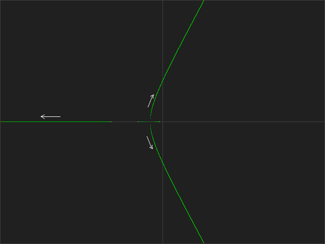

We can look at a system to see if it will break into oscillation when certain parameters
change. For example, if we have a feedback system that has a forward gain K, we might
want to know if increasing that gain will ever cause oscillation or if it will be stable
for any gain K. What we do in this case is look at the roots of the characteristic
equation and see if any roots cross the jw axis while the K increases. I've included a
small diagram of a typical system where the roots, for some gain K, cross the jw axis
(the vertical axis in the center) and since they do that would mean that we would have
to find a way to prevent the gain K from increasing beyond that point in the real life
system or else it would break into oscillation or simply max out and saturate. That would
make the system unusable at that point.
In the diagram, the gain K increases as shown by the arrows. There are three roots to
this system so we track the path of all three roots. Two of the roots cross the jw axis, and
only one of them doesnt. The gain K starts out at zero where the very small white dots
appear, and end at the red dots at some large value of gain.
The plot in the diagram is called a "Root Locus" diagram, and you can look that up on the
web and find out how to do the "Root Locus Procedure" and that will help you analyze systems
that have feedback.
Other methods for investigating stability are Phase Margin, and Gain Margin. There are numerous
other methods too though.
that have feedback.
The two arrows are crossing jw (imaginary axis) from left to right side. if the arrows will remain left hand side...then what will be the conclusion...
The arrows are not crossing anything, it's the green line that is crossing the jw axis but i think that's what you meant to say anyway. The green line is made up of points that have been found to be the complex roots of the characteristic equation as the gain K takes on larger and larger values. The arrows indicate the path the roots map out as the gain K increases.

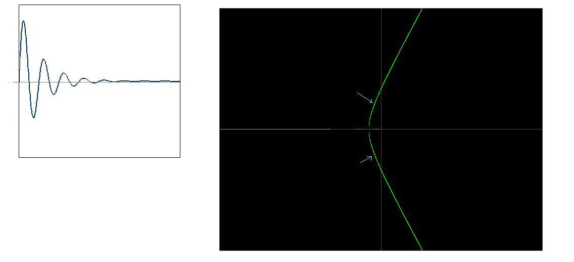

If the roots (the green dots) stay on the left half plane and they are on the real axis, then the response is purely a decreasing exponential with no sinusoidal part (no oscillations in the response as it decreases in amplitude). If the roots stay on the left half plane and they are above (and below) the real axis, then the response is a decreasing exponential again but this time it also has a sinusoidal oscillation riding on that exponential, so it looks like a series of sine waves riding on another signal that decreases. The end result could be either zero or some constant DC value as long as the real part is negative.
The attached diagram shows a typical step response for a system with roots in the left half plane. Note that this would be the response for one single particular value of K in the root locus diagram previously posted. Thus you can see how much information the complex plane offers because it can help us visualize the response for many values of K, not just one single one like the diagram below on the left. The right side of the diagram shows a typical place where the complex roots might be located to get that kind of response on the left. The blue arrows point to the two roots that are shown as small red dots. There are two roots because they are complex conjugate roots.
If the root was on the real axis instead of above and below it, the response would look like a wave that starts out high and then gradually decreases but with no ripples in it.

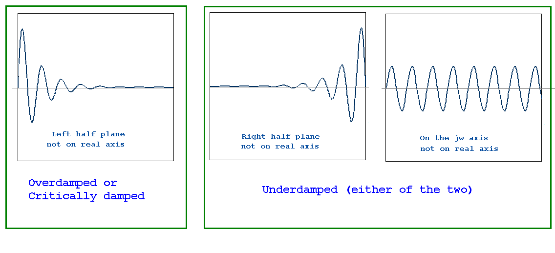

Hi again,
Im not sure what you are asking, but here are a few diagrams that explain a little better left and right half plane and jw axis poles and damping.
