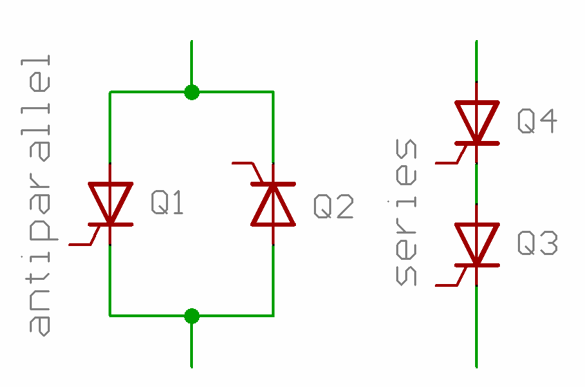

what is anti parellel SCR
can someone tell me what are anti parellel SCRs ? read it
Its when the anode of one SCR is connected to the cathode of the other and vice versa. [the SCR's point in opposite directions and are connected in parallel]
So you have two SCR 's that will function like a TRIAC.

"Series" is end to end in a line with opposite ends connected together and "parallel" is side by side with the same ends connected together...."anti-parallel" is just side by side but with opposite ends connected together.

The SCR's are connected in anti-parallel in the way I described, which is the standard convention for this method of connection.
