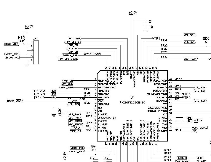

My last PK3 died because of the old win7 driver problem, in a nutshell if you switched from pic 18 to say pic 24, the driver had to be changed each time, it would download from the web every time. But with intel based win7 64 bits it would brick them. Microchip offered me a ICD3 with the cost of the PK3 discounted, or I could have another PK3 free, I chose to upgrade to the ICD3.
The PK3 they didnt want returned, but its well and truly bricked.
Hi LG, Been using PK3 ( two ) with win7 (32 and 64) with PIC18, 16, 24 and dsPIC33 4 Years or so , never had a brick , "download what from the web ?" It has to load the AP for a different device , and usually gives a connection failed a couple of times , but eventually plays ball.... still got the blighter ?
I still have it, they gave me the firmware to reburn the chip but it was dead as a dodo. With mine it never gave the failed to connect message, some systems apparently (like mine) would just say connecting forever.... After a couple of hours you disconnect and its dead. There was some posts on MC forum a while back on it and MC offered to replace these.
It was a specific driver that was by microsoft, it had something to do with certain processors from intell and win 7 64 bit. I dont remember all the details now, I will look for the thread on here and MC, I remember having alot of contact with MC over it. They were great at the time.
Ok a little different I'm running an old 2.4g AMD Sempron , you have the FW, how did you try to flash the PK3 internal PIC device ? ( had to do this with PK2 once not a 3 )
flashing it is a nightmare!
You take it apart and on the board is a tiny, and I mean really tiny header. You have to solder very thin wires or pins into these holes, I then used a junebug (I think) to actually flash the software. Somewhere on MC forum is a long long thread on the whole painful episode.
Looking back through this forum, there is a number of threads that state the ICD3 is replaced without charge and comes with a lifetime warranty. Then again any company selling ICD RJ11 sockets going into a normal pin header for ICSP programming, and charging £12 for it is a rip off.
Yes I see the small line of holes , are they not the 6 standard ICSP pins ? I need to look at the PK3 schematic, How about changing its device...
Edit ... J2 on the the PIC24...
Yes the small holes are connected to the chip in the PK3. I could change the chip but no idea if that will fix it, MC have a pdf on USB drivers written after the problems became apparent. My main issue is the ICD3 was a life time warranty, it used to be all over their website and indeed on here. It cost alot of money, for $50 I can get 4 pickit 3 clones!
