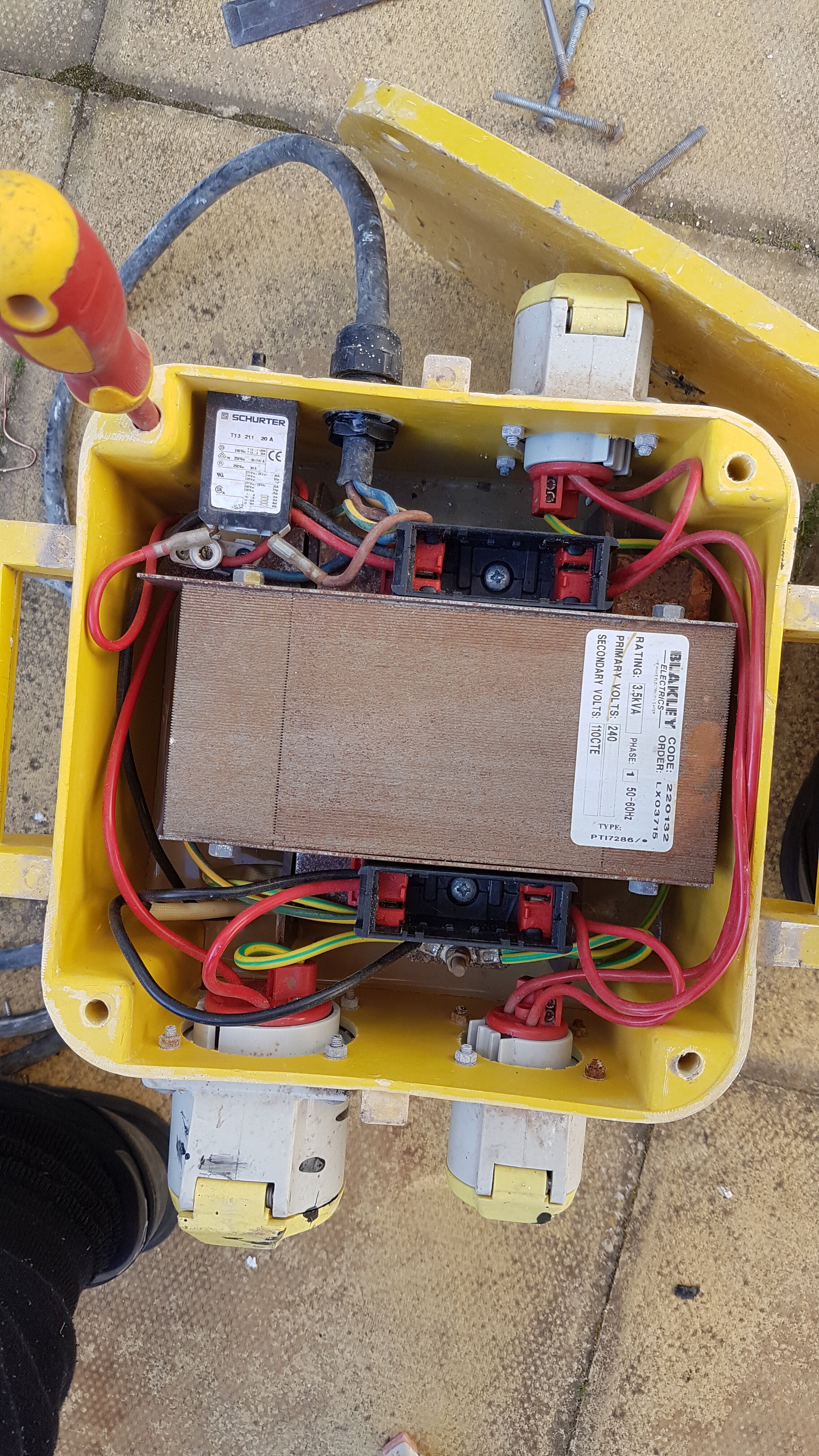

What fuse or component needs to go inside this 110v site transformer?
Compton
I have a 110volt construction site transformer, the big yellow ones.there are two black holders with red parts inside; where there are missing components that I assume are fuses or circuit breakers. Does anyone know what they are. The blades holders are off centre unlike normal fuses.
TIA.

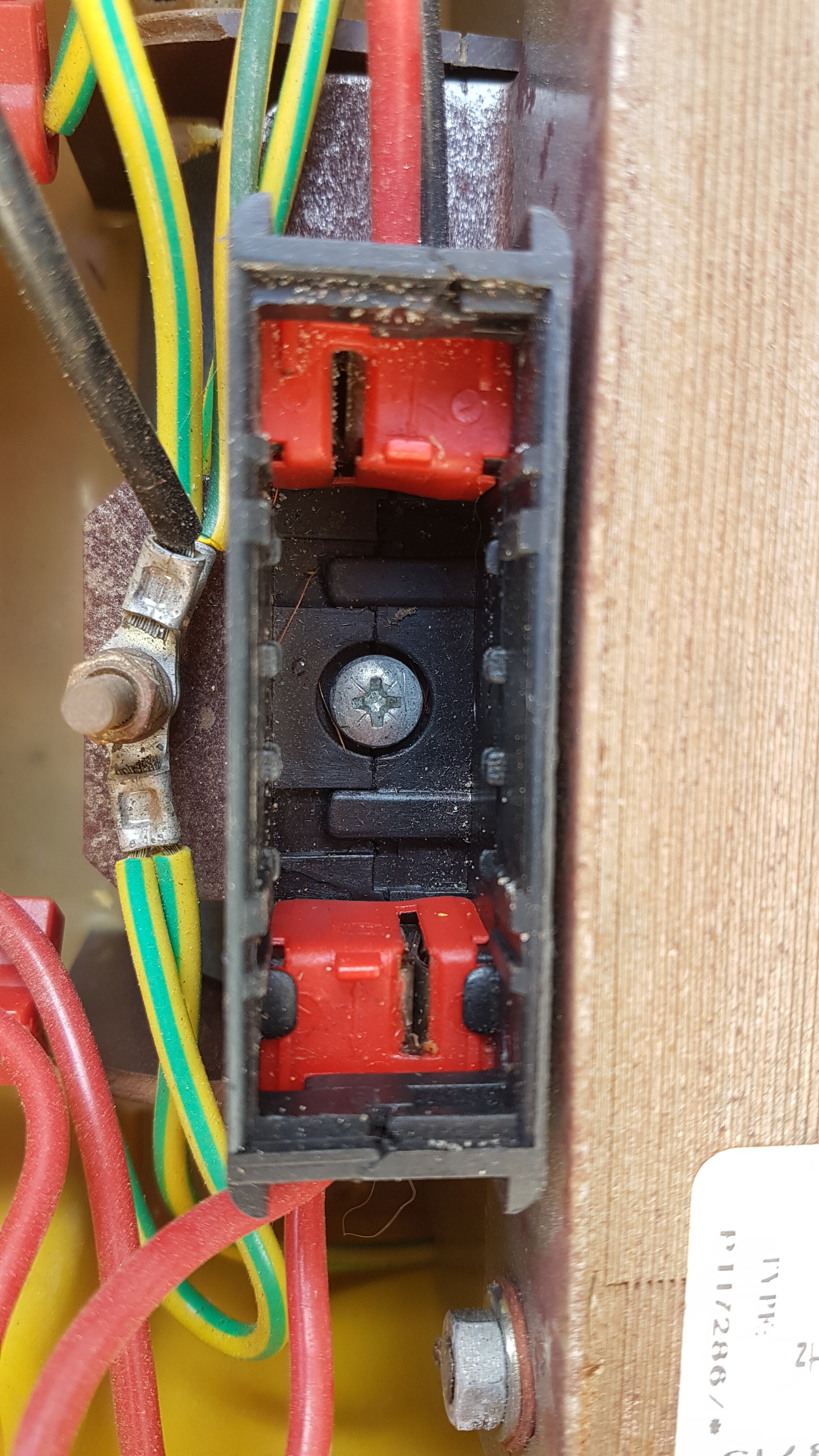

What about a "fusepuller"?
For that style, the cover IS the fuse puller.
"Lawson Clipfit" are another type in that style:
Whether its those, the GE ones that KMoffet posted or some other type, the fuse body latches in to the lid and its blades or tags fit directly in to the holder, rather than the lid having separate electrical contacts.
The simplest fix is probably just to buy two new NS type fuse holders and replace the existing ones.
These are the fuses to fit, by the way:
