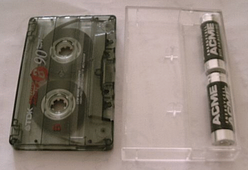

if you are talking about boxes heres a cheap alternative.
and it fitts "AA"'s perfectly.
