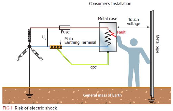

Earthing theoretically-floating metalwork is a tricky subject. In industry, pretty much any piece of metal anyone could come in contact with would normally be earth bonded - eg. metal control cabinets etc.
But, I've just searched to se if there are any regulations & found this, which seems counterintuitive to me.
Taken literally, such as machine tool beds or chassis should not be grounded as they are not "part of the electrical installation"??
I'd think anything that could become live due to an insulation failure should really be grounded / earth bonded, with an ELCB in the power feed to the equipment if people can come in contact with it.

It's all a matter of degree - however, it's probably a requirement in the UK that large metal items like that are earth bonded anyway, in the way that all metal pipes need to be.
Safety wise?, it's all a matter of perception - under some circumstances earthing items increases safety, under other circumstances it makes it far more dangerous. However, for the general public, the decision has been taken for you, and legislation states what must be earthed.
