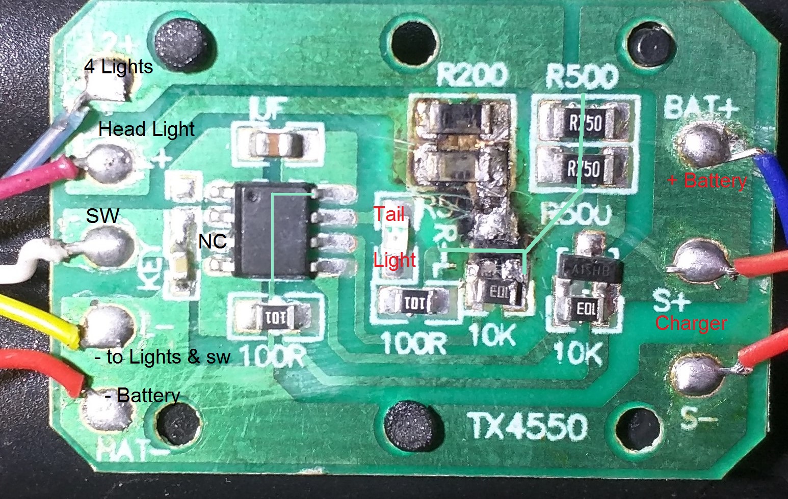

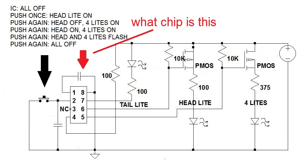

I got a "head light" I got from friend and it didn't work, I traced the circuit and came up with what works, but one chip was not identifiable.
It's designed to worn on the head and has 3 lights on it, the head light, the 4 lights for long distance and the tail light. Starting with every thing off, first push on the button turns on the head light, 2nd push turns on the 4 lights while turning off the head light, 3rd push turns the head light back on, 4th push makes head light and 4 lights flash, 5th push turns everything back off. The tail light is on constant when either of the other light are on.
I would like to know what the control chip is.

Either it's a ridiculously specific custom ASIC made specifically for that board or much more likely, it's an 8-pin microcontroller because only only an 8 pin micrcontroller could economically contain that functionality if you're churning out less than tens of thousands of these things (even that quantity might not be enough for it to be economical). That would mean that Pin 4 is reset. 1 and 8 are power.
EDIT: Yup. Quick search of datasheets on Digikey for 8-pin microcontrollers came up with this MCU whose pinout matches
https://ww1.microchip.com/downloads/en/DeviceDoc/40001723D.pdf
It has an unconventional wire up where pin 1 is not directly connected to power. Instead, it's drawing power through the Vpp/Reset pin 4 through a particularly small pull-up resistor. The cap across pin 1/8 is the decoupling cap. I wonder if anyone knows why they would go out of their way to do it like that since it doesnt seem like it would save on cost. Did you mistrace pin 1?
In any case, it doesn't matter what the chip is specifically anymore because even if it was an ASIC you could replace it with that microcontroller and get any circuit behaviour that you want. With an unused pin 3 you could do whatever you want. There is an ADC and UART and a bunch of other stuff crammed into that thing. Quite impressive.
It may well be that 8 pin Microchip part. But unless you are going to write your own code for it, it doesn't matter - a non-programmed part won't do a thing for you.

It could be a microcontroller from some other manufacturer. (Possibly Chinese.) I have lookes at the pinout of the Atmel ATtiny 8 pin chips and it does not match their power pins. I agree with dkuguyen that writing code to use one of the PIC12F or 8 pin ATtiny range would be the easiest solution. The tracks on the board could be cut and wires added to use the suggested microcontrollers.
Edit. It is possible that the control chip could be OK Have you tried cutting the tracks to the mosfet gates in case they have gate to source shorts. You could then look at the signals on the output pins.

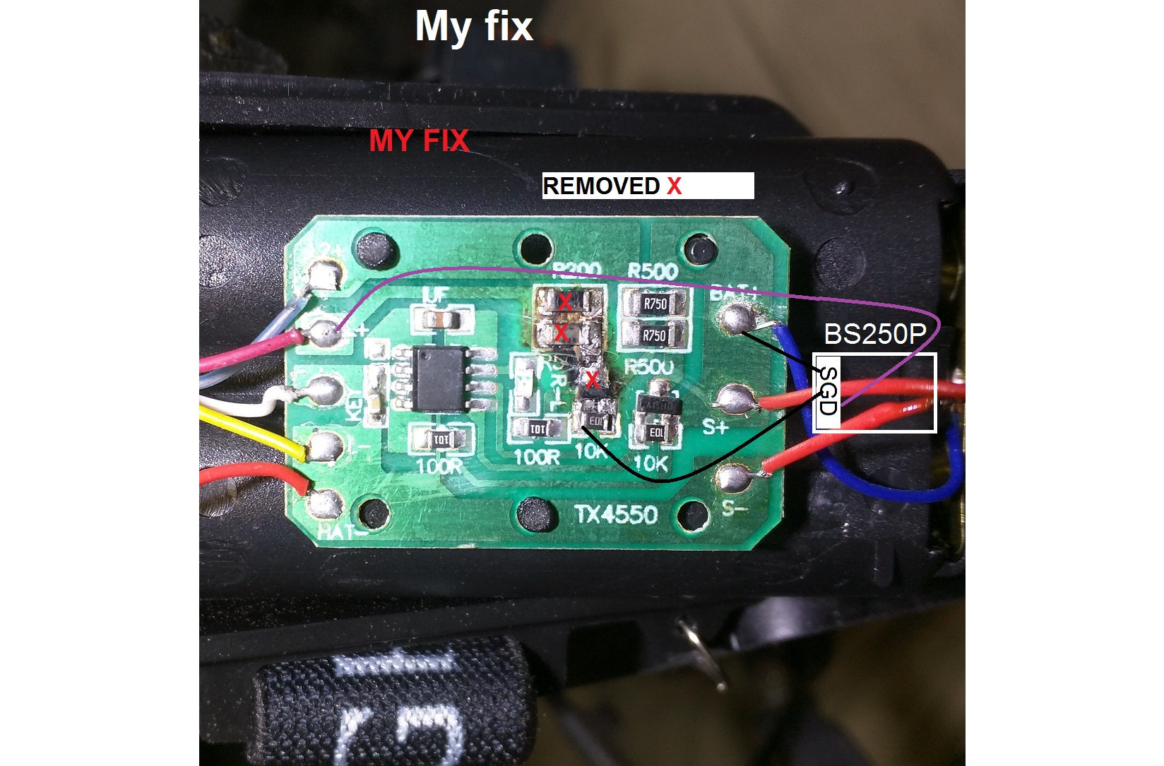

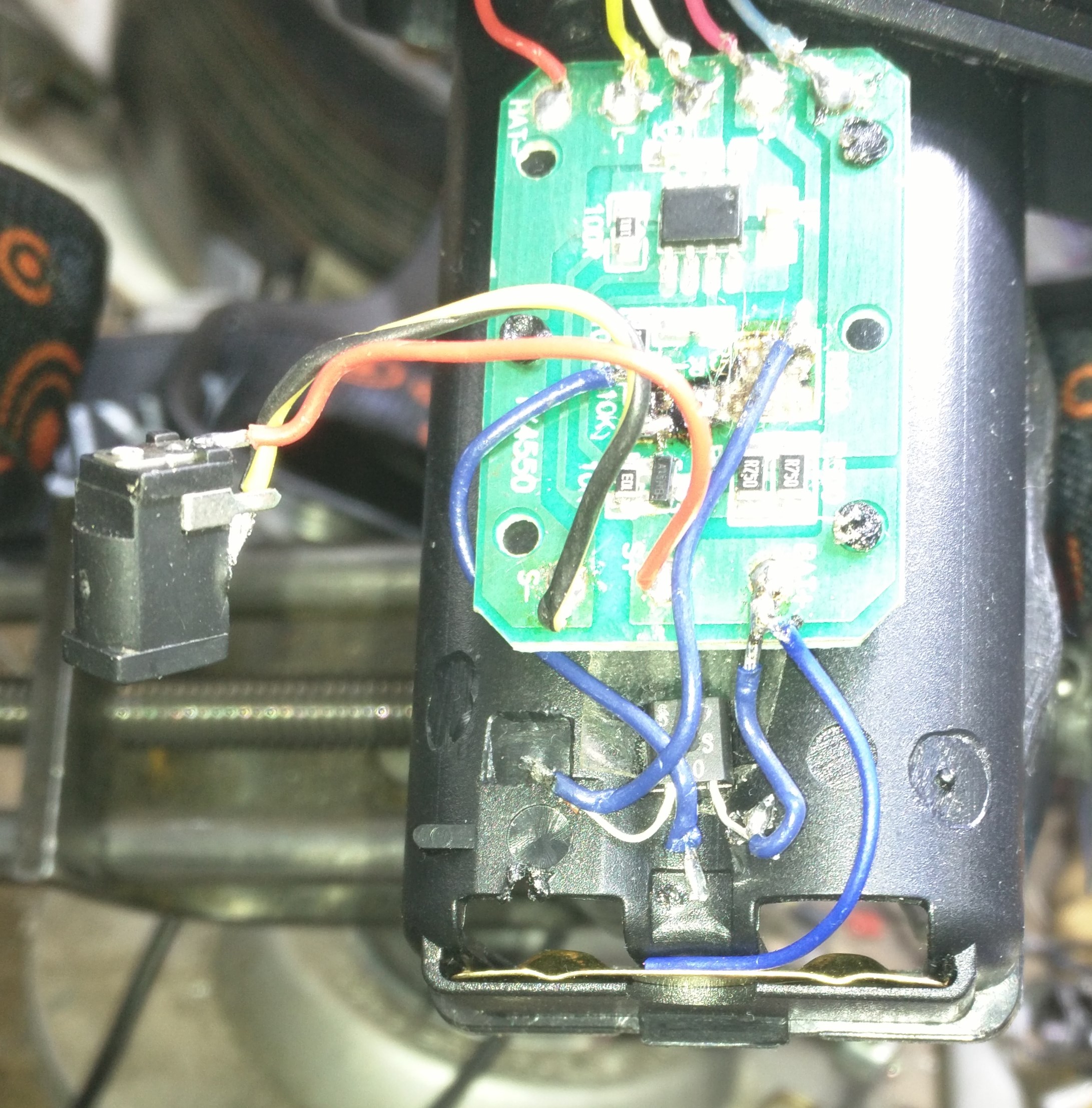

I suspected that the chip would be preprogrammed chip as suggested in previous posts, but the failure was in a PFET and was replaced with a TO92 after removing the damaged components. Works good now.

I'm pretty certain that I have all the traces correct, pin 3 has no connection, pin 8 goes to ground, pin 1 goes to the cap and pin 4 goes to + power via 100R, that seemed strange to me,

The chip was good, what ever it is and the BS250p PFET is working good.
