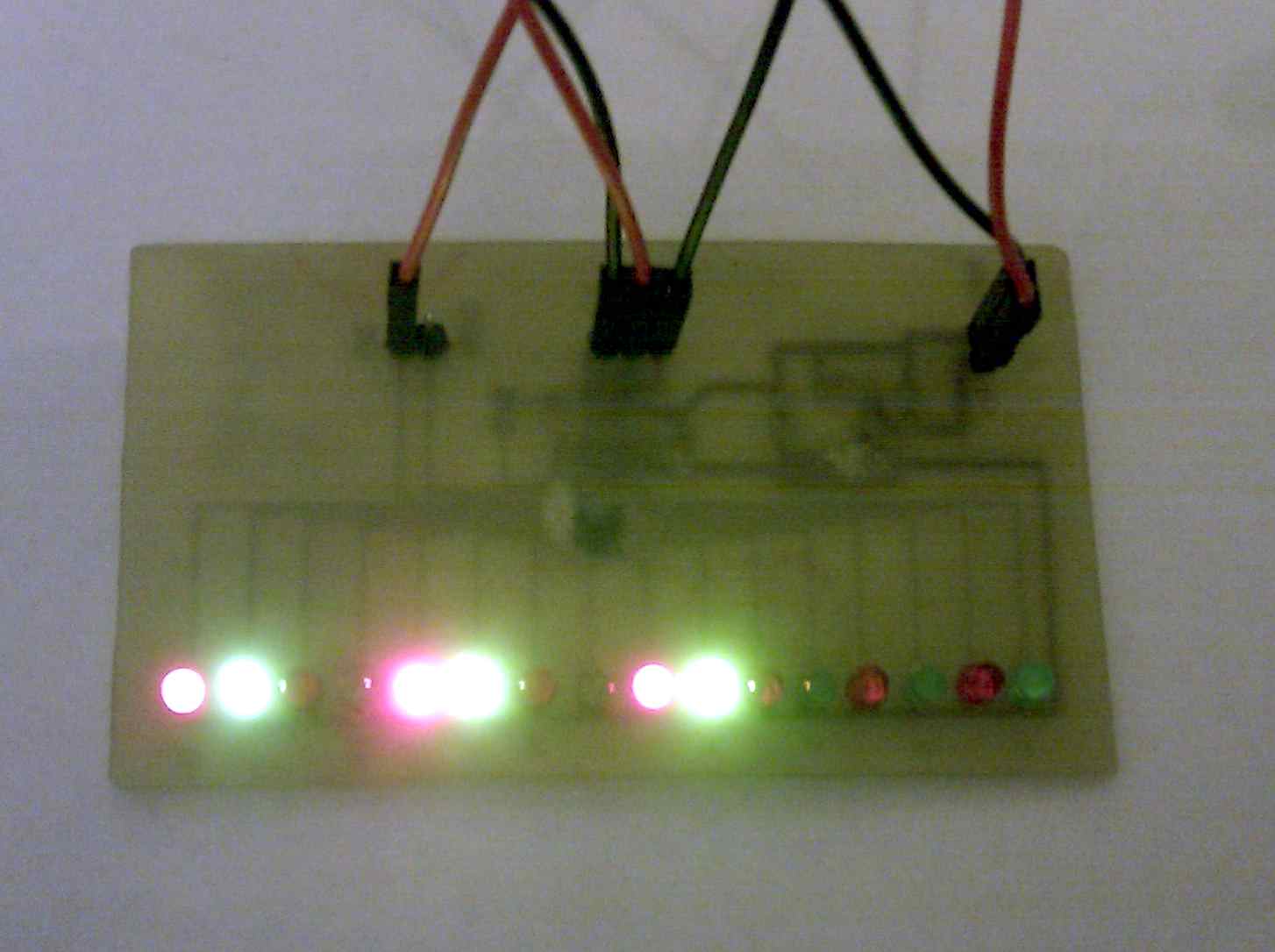

Hello friends i am trying to learn led drive with STP16CP05 spi led driver. I did a lot of thing but i coudnt success to led on-of or blink. I am using CCS. Anybody can help for me? Here is my source code. Thanks for all your help or idea.

Thank you ian for your reply. When i put in main function i get error message
*** Error 53 "stp16cp05.c" Line 47(5,13): Expecting function name
cant recognize led_data function.

Ok... Where are these two functions.... You need to create the functions if you want to use them...

Sorry my compiler used old source code too thats why i got those error code.. now i have only one error code
*** Error 12 "stp16cp05-new.c" Line 57(20,38): Undefined identifier b01000100000000001
1 Errors, 0 Warnings.
So, can i connect external clock generator like 555 . I just connect that pin direct to Gnd.
Should be okay.... But if the power isn't an issue just ground it... You can do that for testing anyway!!
Change b01000100000000001 to a hex value 0x4401... see if that works I don't know your compilers binary suffix..
Ian it woooorrkkkkkssss.. :D:p:) Thank you very very muchhh. I can even change the led situations. I dont know why not accepting b01000100000000001 but accepting hex value 0x4401. Very strange. now i changed to CCC0 led like i wanted 1100110011000000. By the way OE connected to GND. Only works like that otherwise not working. My mcu is 16f877. I had to delete also #FUSES NOMCLR line otherwise complier gives error. somebody told u cant make mclr off because pull-up true? Any way like this works perfect.

Ian hello again. After that i tried some kind of other ideas, like one or some of or all are blinking leds. which codes i need? and to which line i have to put that code?
Thanks again for helps:
i am trying to do, for example led 1,3 and 5 500ms blinking, led 4 and 8 800ms blinking or something like that. or all are blinking in 500ms .
Use Timer0 to give a 100mS interval..
Then setup a bit of logic to monitor the state of the LED's... For instance.. A mask for each time the timer overflows..

Try and use code tags... Its a lot easier to read with the indentations... I've done it for you use the little cog symbol to insert your code...
If you want all the LED's to blink at the same time.... Well that's easy just clear the LED_data every other 200mS or so...
What's the purpose of the "counting" function?
